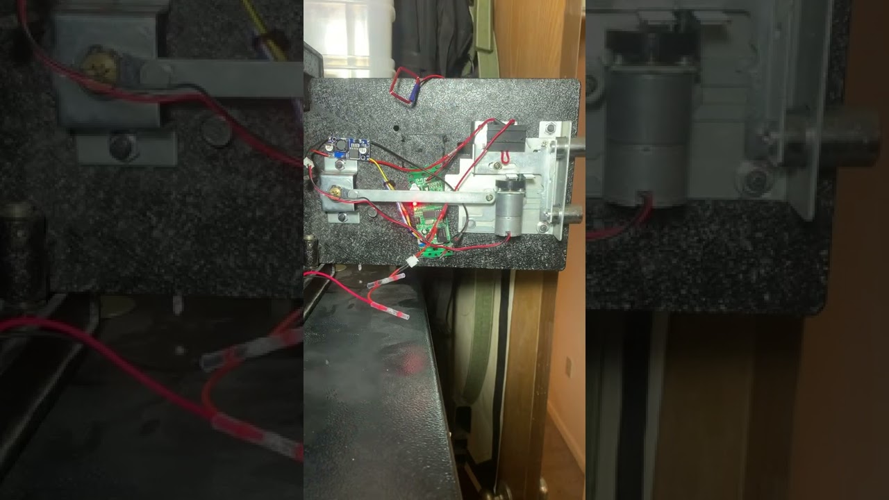

Pistol safe refit project
Googley eyes got it
Step 1:actuate lock :white_check_mark:
Step 2: limit power usage with a timer relay
Step 3: clean up and cable manage
Step 4: design and print a new faceplate
Step 5: address a few attack vectors
Looking good so far. I like it. (And frankly a simpler solution than trying to program a mcu)
More like Simpler than teaching me how to program one, I’ve bugged @enginerd more then I care to admit…Relays are stupid… that’s all I have to say
I’m self aware enough to know that programming a microcontroller is skipping a lot of levels for me
3D printed and installed some standoffs so things aren’t flopping around anymore… that’s good
But it’s getting messier now that I have the timer board in, start button, and various power connections
:open_mouth:
Step 2: limit power usage with a timer relay :white_check_mark:
Step 3: clean up and cable manage :white_check_mark:
I think most of the wiring is done now (maybe now
I can leave you alone @enginerd)
Still waiting for power panel socket to come in, that will go in the back, already have the lead wired and tested
Also need to get a more appropriate rates fuse, just used what I had on hand as a place holder… I just need to go to the store for it… I hate buying small things like that, because now everyone regardless of Amazon will want to sell me a 100x pack for 7.99
I just need 1 or 2, chill lol
But overall I think I’m getting there
Step 4: design and print a new faceplate :white_check_mark:
Step 5: address a few attack vectors :white_check_mark:
Bonus step: sticker swag :white_check_mark:
Just need to drill a small hole for the female dc jack connector in back, and attach it to the wire coming out of the door… and it’s 99% done (nothing is ever fully done)
Pretty much done with the official project
I think I’m might tinker a bit further with some creature comforts…
Like spring loading the door, possibly something that holds a pistol in a more convenient angle…
I did think about something Extra where the handle dips out when open lol

That is a clean install. Especially with the dc jack in the back. Excellent job frood!
Door is now spring loaded
Really rough hack job, may not last, but it works for now
Took a Glock 17 magazine spring and cut it all
Up and bent it all up to make a spring that forces the door open
Haha. that’s brilliant.
When you mentioned spring loading the door, my first thought was something more like this
