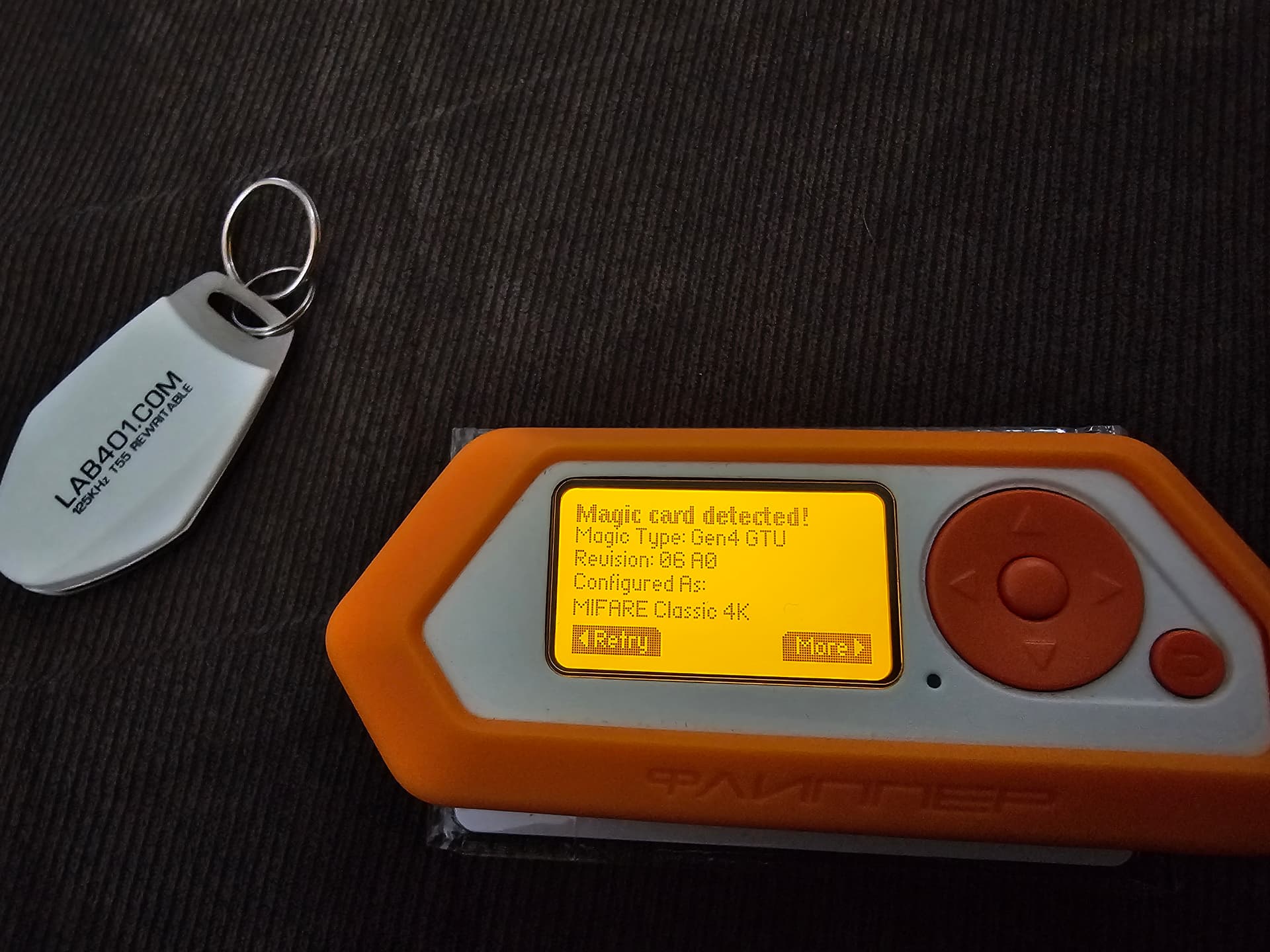

Some goodies came today. So far no issues with either proxmark or the flipper. Going to play more with the proxmark in a bit.
edit. Damn, the controller inside this card is dope AF! I do not regret buying the implant!

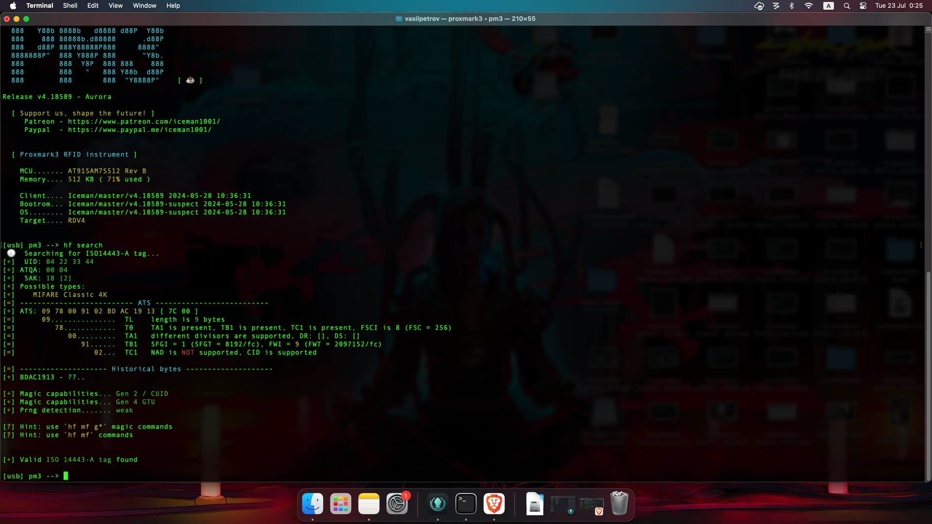

I can say this - so far reading with flipper and proxmark rdv4 success rate is 100%. I did 10 consecutive reads per each, with 0% failures.
Was able to read my FlexUG4 with the PM3 on top, so the serial # was positioned over it, like Amal mentioned somewhere.
Once you know the exact single place it works at, it works every time.
