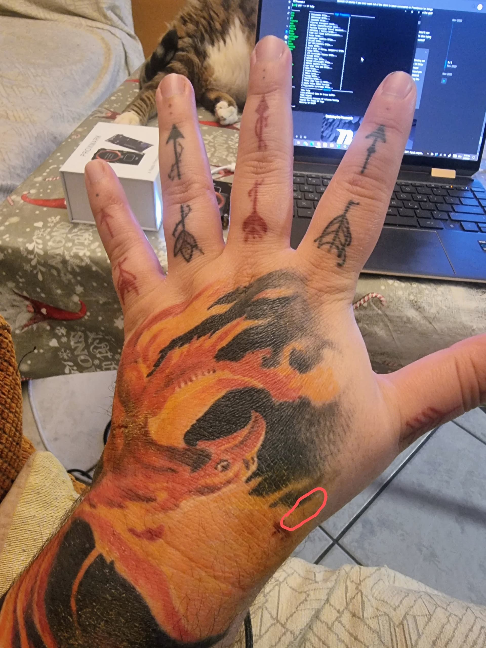

This is my proxmark, with a (kind of) circle i drew where i had a repeater sticker
I removed it, because it made things worse: i was not able to even detect the Apex anymore
I had to find my exact implant location by moving it under my skin
When i found it, i lined it up perfectly with the serial number of the proxmark and pressed with a lot of strength
Still nothing :confused:

Btw, my flexUG4 is in P0, my Apex Flex is in P4 and my flexEM is in the wrist
I was curious about that. Based on the picture you sent me, I wasn’t sure if it was p0 or p11 for the flexUG4. Is it actually in p0?

I may have got confused with the positions
Heres another pic to clear things up
I may have got confused with the positioning, but heres a picture to clear things up:
Green or blue? Basically, is it along the bone or in-between the metacarpals?

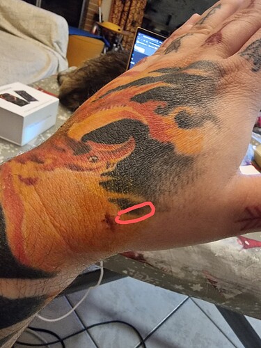

In the middle. Basically its the imaginary line that forms the red UG4 letters
Could be. Im not 100% sure.
I will upload 2 more pics to help you:
It looks closer to p11 than p0 to me. It appears to be more or less along the bone–p0 is the no man’s land in the webbing between the thumb and index finger.
I see.so p11 is the more likely placement. Is it a good placement for the flexug4?
There is a lot of bending and flexing there, it wouldn’t be my first choice.
It’s perfect for my xSeries.
It will really depend on the actual placement and your anatomy.
I hope you have good success with it there.
Thank you. Lets see as the time goes by, if i can get a read with the proxmark and what the experience will be with the flipper zero!
