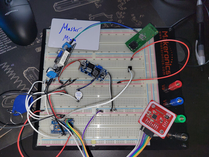

Alright, prototype in a working state. Still need to tinker with the simple ac code to get it to do what I want. but card is read → on success key gets power, car unlocks… huge fucking win in my book!!
Next steps
-understand how to remove these two buck converters from the project
-modify code to deal with both inputs(car off/ car on)
-wire up other buttons like unlock and trunk
- 3d print enclosure
-maybe come up with a pcb?
-install
Alright the prototype is in a working state!! Key is wired up, the thing talks to me when you use it, all the voltages are correct, and It functions as intended!!
Next step after this is to figure out how to wire it in from the car.
Mock the ignition wire so I can get fancy with the programming
Scale this thing down somehow?? Way outside my area of expertise.
Print an enclosure and install
If anyone can point me in the right direction with software/ resources to make this thing smaller I’d be super grateful

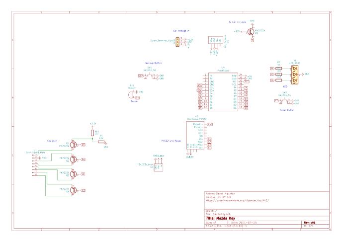

Alright feeling like Alice at the moment. Learning Kicad to scale this puppy down, and possibly create a PCB from this thing.
If anyone can read these things or have any pointers I’m all ears. This is my first electronics project as well as the first time I’ve opened a CAD program. Pointers are welcomed.
Here’s the Kicad Files if anyone wants to look around

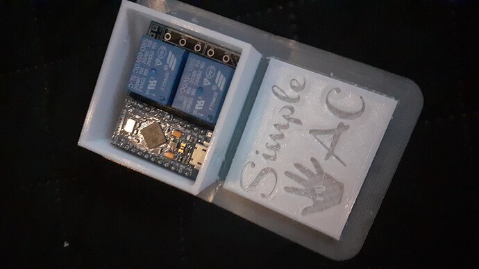

This one’s still sitting as a prototype on my desk (I’ve been carting it around for a few years now) I’m switching gears to a different older less complicated car to wrap my head around things, but hope to pick this one back up at some point. I still love my Miata, and the dream is still no keys!
Follow along with the hopefully much simpler one for now.
