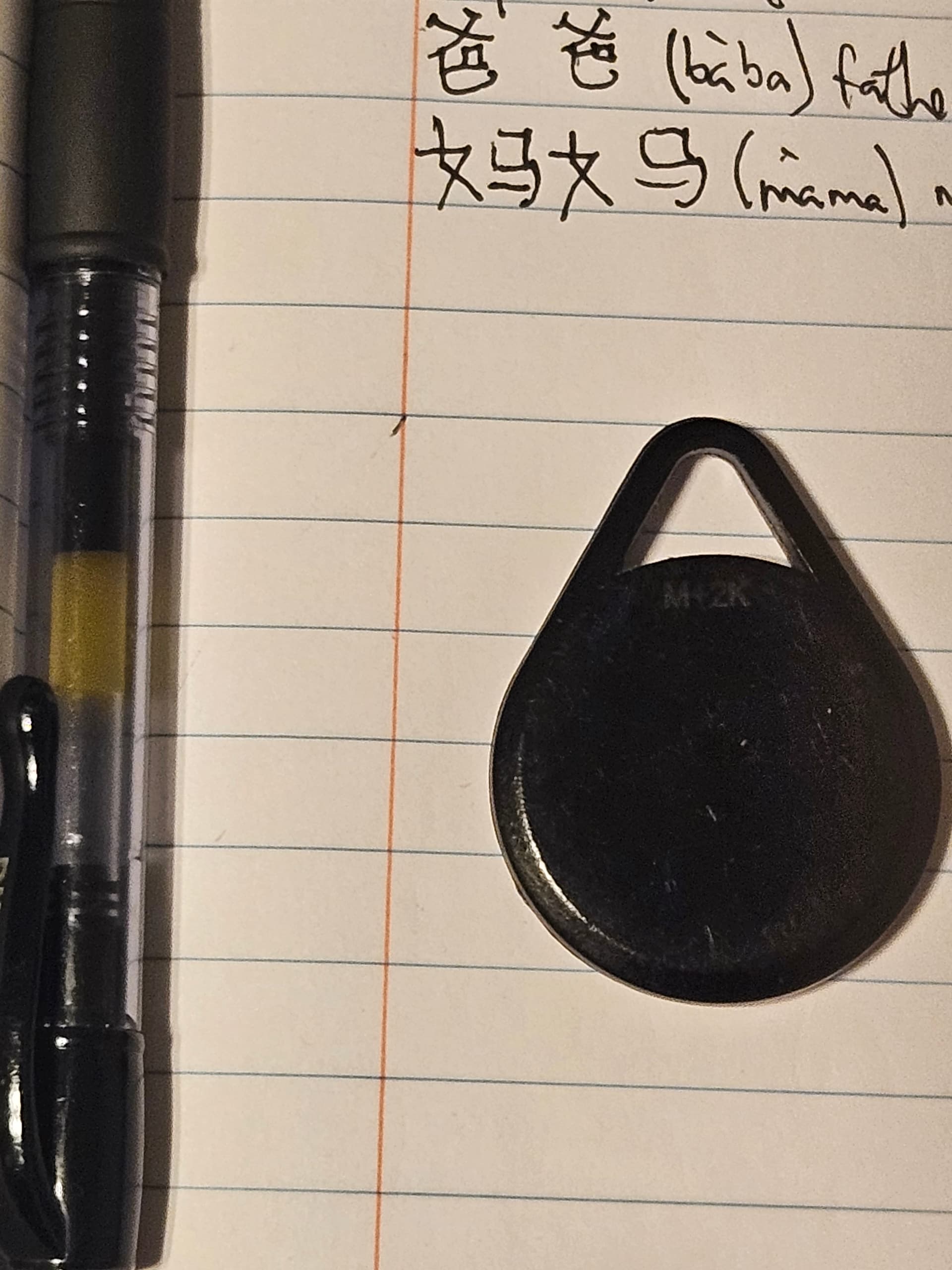

Here is the image of the chip type detected by the Proxmark 3. Proxmark is having difficulty identifying the exact chip type, but it a Mifare Plus 2k chip used in the access control system for my front door. Attempting to clone it before with MCT has some issues, so that’s why I purchased the Proxmark, so I can do more research in the subject. Finding an answer for this would also put me forward in the major I am currently studying, accelerating my progress towards my current degree.
Editing for adding the picture of the chip in question.
Notebook for contrast, pen for scale. The chip reads “M+2K” at the top.
I’m trying to clone a Mifare Plus 2k key fob that’s used for the access control system to my apartment’s front door. It’s data has been previously cloned and emulated by my Flipper Zero.
