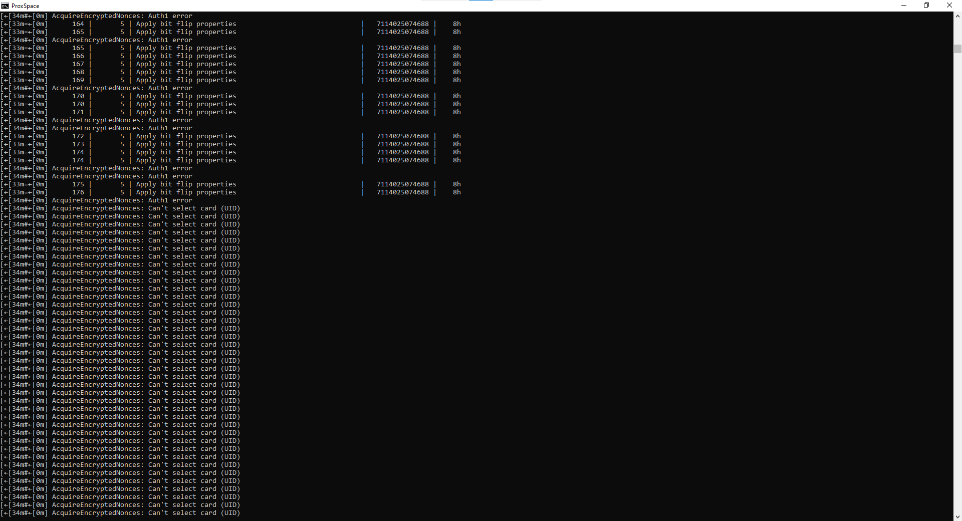

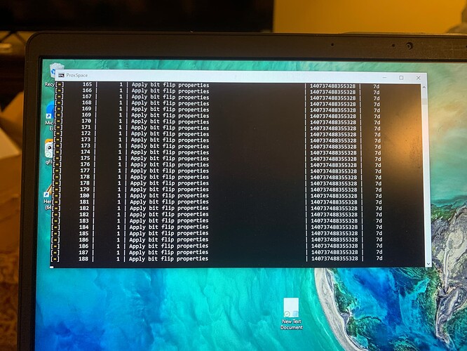

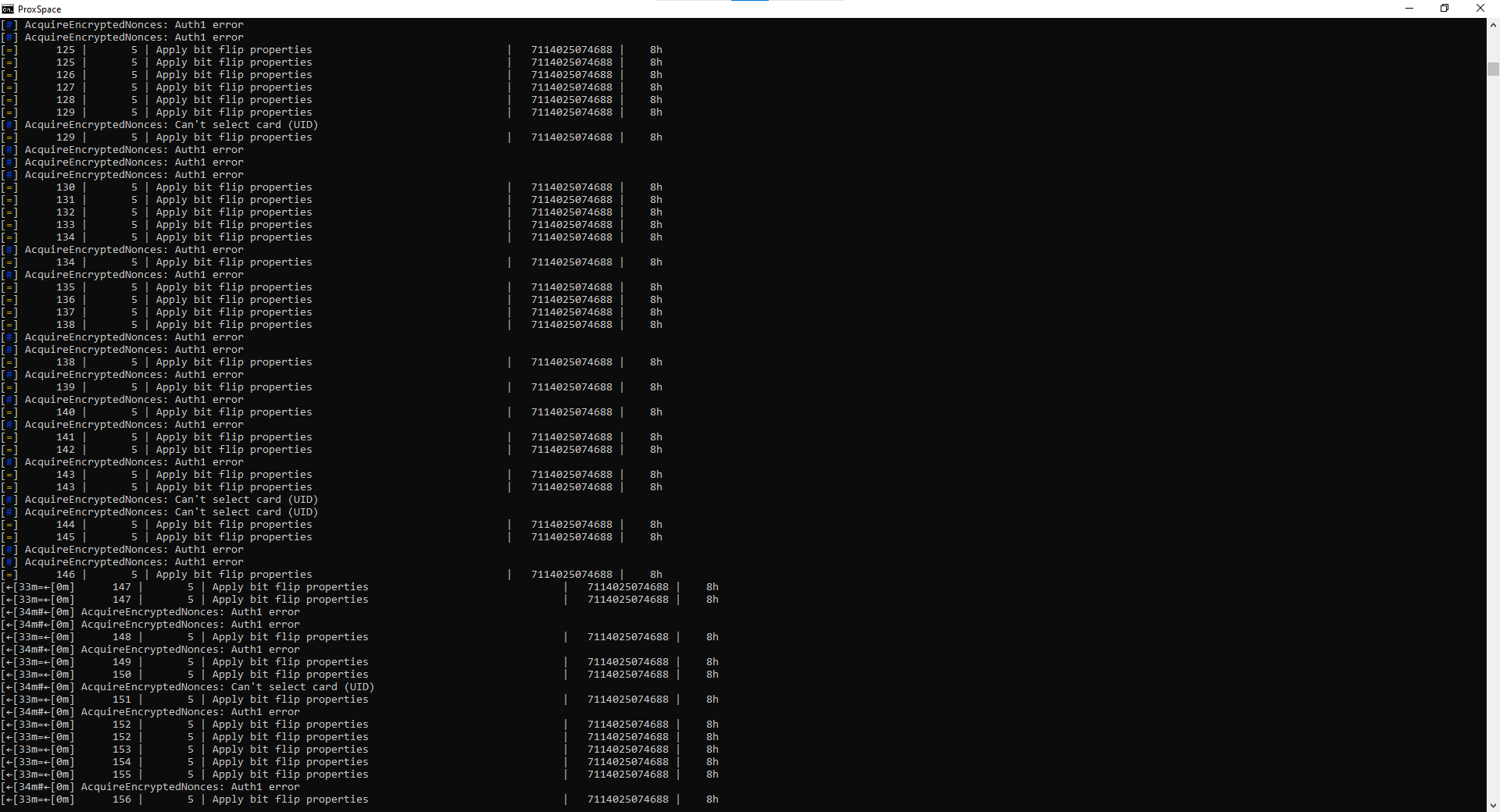

here is the opening
this went on for some time, then it changed a bit
then it went to hell and stopped registering

When it says auth error looking for nonces
Was that actually working? Or just repeatedly erroring out?
I’ve tried running it again, and it won’t stop like it did before but I don’t know what the bit flip and auth1 error stuff mean
I’m pretty sure auth1 error is just exactly that… sending the auth command and getting an error response.
The thing about it is that I don’t know if a burnt sector is going to return anything but an error. I don’t think it has a specific error return code that is different for a burnt sector than one that is just not authenticating because yours passing the wrong key. Basically I’m saying I don’t think there’s way to tell if a sector is current or locked by sending key authentication commands. The return is likely going to be the same error code.

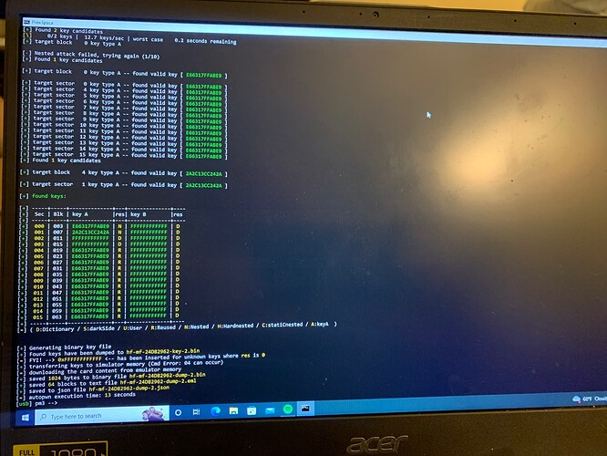

I ran a hf tune and very carefully put the iso in the strongest posistion and tried autopwn again
It’s not throwing the auth error code, is that better or worse?

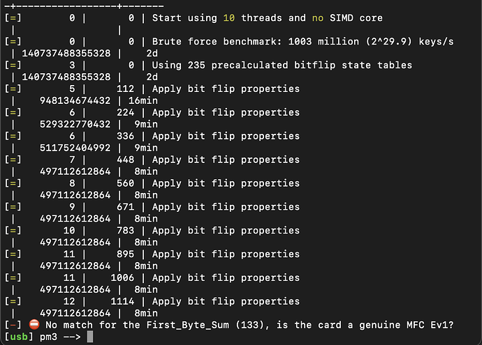

In my poking I’ve found 2 things that I don’t understand that could be parts of the equation… there was some issue with autopwn and nested attack with iceman… but it looks like it was fixed?
If I try to initiate the nested attack manually it fails saying it can’t find the .bin file…
(I have no idea what the nested attack IS, just that proxmark seems to try other stuff before hand and eventually escalates to this… something online had said they couldn’t get autopwn to work but running it manually worked)
So good chance I’m doing something wrong or have no idea what I’m doing, but maybe something is wonky?
Additional potential flag…
During w/e the proxmark wants to do, I can’t exit or quit or anything… and I’m forced to close the client entirely … not the end of the world I guess
Afterwards windows ejects and reconnects to it… so maybe the hardware is getting locked up?
