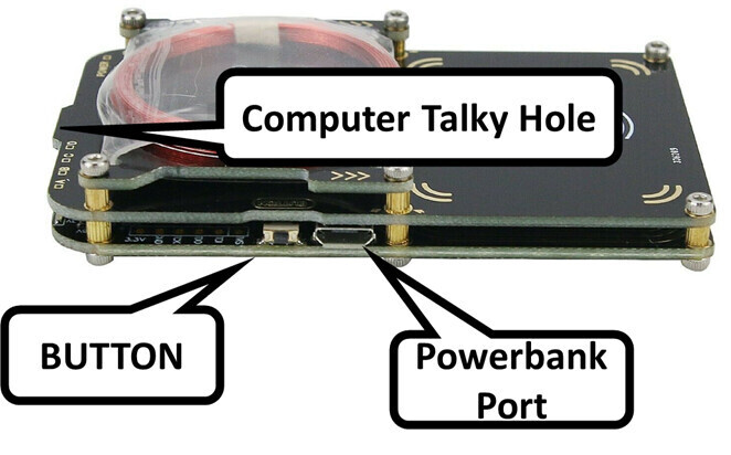

You are plugged into the Short edge (Computer Talky Hole) NOT the long side
