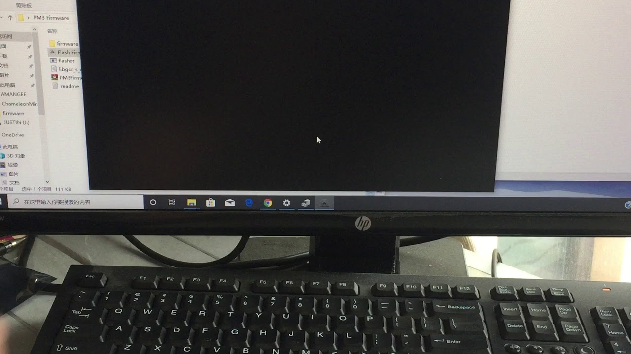

I followed this one
FYI somebody else grabbed a Piswords one that was ā€œsupposedā€ to be iceman… but it wasn’t. So that actually could be your issue
Also no software was included or instructions, so I downloaded… whatever piswords linked to I think,
Which is a jumbled mess with little to no explaination…
Would their video help?

Sort of,
Except I don’t have the files he’s showing… and there’s no links to wherever the hell they are on piswords website lol

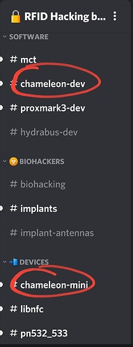

If I was in your position, I would contact IceMan, especially if you explain your project I think he would be keen to help.
You could try the Proxmark Forum, and
I know you don’t do discord, but he is really active there plus some other clever cookies :cookie: and there are two channels that would be of interest to you.
(I’m sure you are aware, but the chameleon Mini and Tiny are virtually the same except form factor)
Use a proxy and here is a link to the Discord
