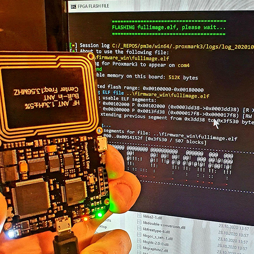

Updated my PM3 Easy with new firmware successfully.
Started with hw tune and lf read @ to find the sweetspot of R0.
Iāve then successfully written EM, Jablotron and FDXB codes to the LF side of my NeXT, all verified with PM3 RDV4 and PetScan. But the problem is, no matter what I do the pm3 easy was only able to read back the EM code.
It comes as a surprise, but I guess everybody usually has the external way of verifying the written implantā¦

Basically the pm3 easy has a shitty weird firmware on it with a crap bootloaded and I have to push a different bootloader first, then another bootloader to bridge the gap, then I can push the iceman bootloader and full image⦠and how you do this requires different holding of the button and power cycling the pm3. Itās a serious pain in the ass⦠but once we sorted out the order of operations itās somewhat easy for us to upgrade them in batches.

So the JTAG security bit is still set? Hmmmm, that could be interesting if any of them get brickedā¦
Found info about the security bit being set / how to reset it here, here and here. Anyone who wants to reprogram their own easy via JTAG will likely need to erase the chip as shown in those posts.
