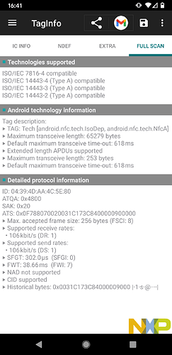

Does anyone who knows more about Smartcards think there’s a way to figure out the expiration date from the ATS? Here’s mine from the first batch of Purewrist

no there is not. you must issue various APDUs to select the payment applet, then request track 2 data and extract the exp from that (and the card number too).
You’ll need to learn EMV commands to do this but basically there are some steps that build on each other;
  • get list of AIDs from card (application directory)
  • select payment system applet (various exist depending on card manufacturer and chip OS)
  • list the payment networks loaded (usually just one but can be more than one or different AIDs)
  • select the payment network desired (again usually just one exists, but can be different AIDs)
  • request track 2 data from payment network data (standard EMV command for track 2 request)

ATS:0031C173C84000009000
> 00 A4 04 00 0E 32 50 41 59 2E 53 59 53 2E 44 44 46 30 31 00
< 6F 3A 84 0E 32 50 41 59 2E 53 59 53 2E 44 44 46 30 31 A5 28 BF 0C 25 61 23 4F 07 A0 00 00 00 04 10 10 50 0A 4D 41 53 54 45 52 43 41 52 44 87 01 01 9F 0A 08 00 01 05 04 00 00 00 00 90 00
> 00 A4 04 00 07 A0 00 00 00 04 10 10 00
< 6F 3D 84 07 A0 00 00 00 04 10 10 A5 32 50 0A 4D 61 73 74 65 72 63 61 72 64 87 01 01 BF 0C 20 9F 0A 04 00 01 01 04 9F 4D 02 0B 0A 9F 6E 11 08 26 0A 99 30 32 33 31 37 30 38 37 30 32 31 36 37 90 00
> 80 A8 00 00 02 83 00 00
< 77 0A 82 02 19 80 94 04 10 01 04 01 90 00
> 00 B2 01 14 00
< 70 81 A4 9F 42 02 09 78 5F 25 03 21 05 01 5F 24 03 29 05 31 5A 08 XX XX 5F 34 01 00 9F 07 02 FF 00 9F 08 02 00 02 8C 27 9F 02 06 9F 03 06 9F 1A 02 95 05 5F 2A 02 9A 03 9C 01 9F 37 04 9F 35 01 9F 45 02 9F 4C 08 9F 34 03 9F 21 03 9F 7C 14 8D 0C 91 0A 8A 02 95 05 9F 37 04 9F 4C 08 8E 0C 00 00 00 00 00 00 00 00 42 03 1F 03 9F 0D 05 B4 50 84 00 00 9F 0E 05 00 00 00 00 00 9F 0F 05 B4 70 84 80 00 5F 28 02 00 40 9F 4A 01 82 57 13 XX XX D2 90 52 26 00 00 00 00 00 00 0F 90 00
> 80 CA 9F 4F 00
< 9F 4F 1A 9F 27 01 9F 02 06 5F 2A 02 9A 03 9F 36 02 9F 52 06 DF 3E 01 9F 21 03 9F 7C 14 90 00
> 00 B2 01 5C 00
< 6A 83
> 80 CA 9F 17 00
< 9F 17 01 01 90 00
> 80 CA 9F 36 00
< 6A 88
*Anyone concerned I have revealed the card number, this specific card number will never be activated because of the peculiar fault in the chip that causes it to be readable for only a short amount of time before going so far out of spec it dies, only to come back after a few minutes.
