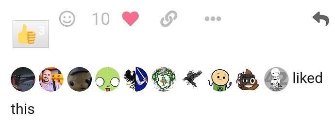

I’m happy to give you your 10th like, which should give you a “nice topic” badge.

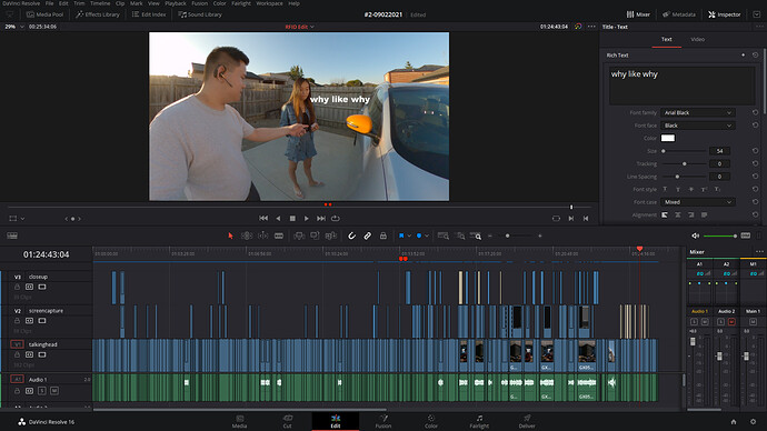

I guess I’ll stop being modest for 30 seconds and say it took me probably 3 days to edit - i was so nervous talking to the camera, and had to cut out every little “uhh ummm hmm you know so you know andddd uhh anyway”
