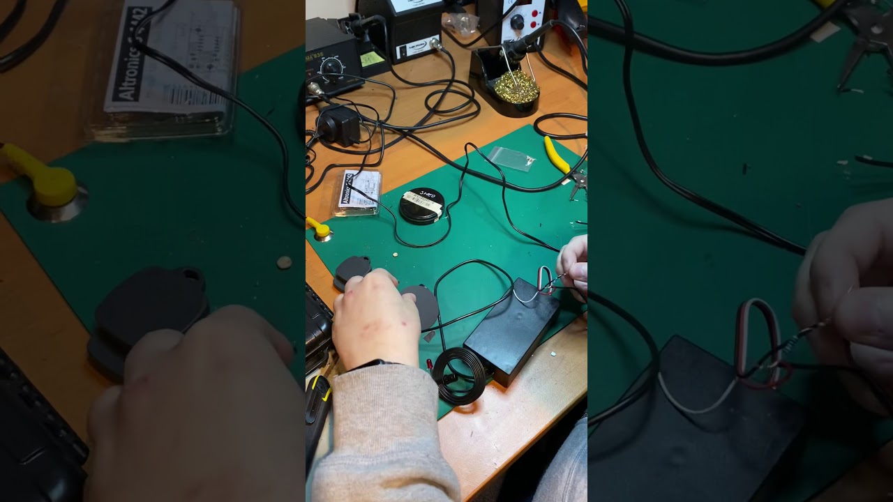

I’ve got it! video coming up soon, I’ve just reprogrammed my test bench one 6 times in 5 minutes. It’s definitely a dodgy ground issue causing it to reset, then first tag is set as master.
I’ve got a repeatable setup, it’s janky but works. Will share details as soon as I’m at my computer
I just love good hacking done right.
Well done Sir.
Once you see how it’s done, I don’t know if you’d agree its ‘good’ or ‘done right’ - but you will agree it’s done!
Took a little while to do it on the actual reader, but it did work!
There needs to be a load on the power wires of the reader (in my case, a 10k resistor between positive and negative) to make the capacitors discharge quickly and make the power less stable, then connect up the positive and rapidly tapping the negative. Do this while you have an enrolled tag that you want to become the master resting on the antenna. You want the light to be flickering as much as you can (the worst power you can deliver!) with the goal that the light should stop responding when the reader has power (the behaviour you’ll see of a master tag).
Once this happens, it should now be the new master. I imagine you can do this without the tag held to the antenna, but this gives it a good indication of if it worked and makes sure the first one it sees is the one you want as master.
