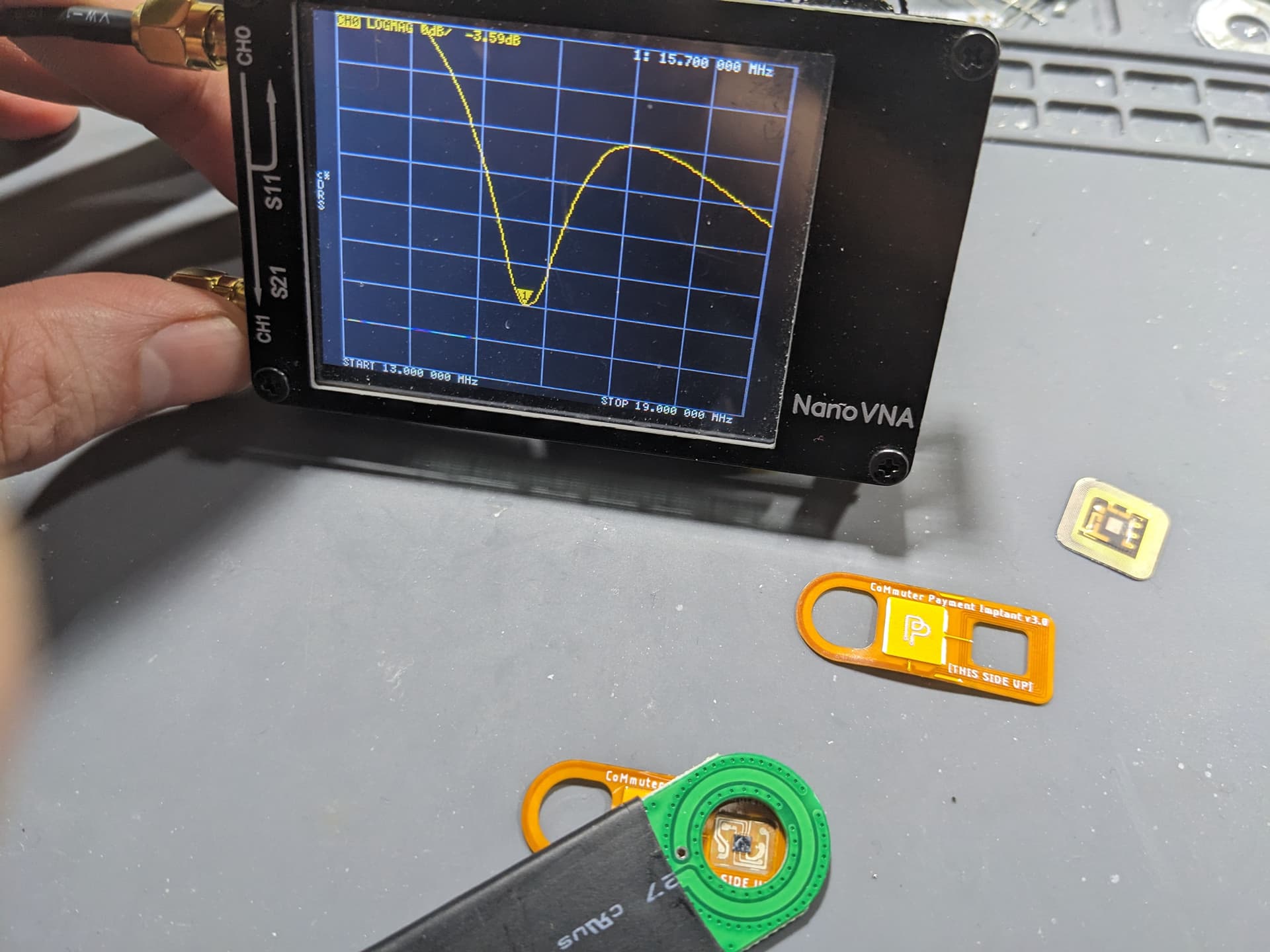

Mine is in the mail. I need to decide whether I want to do 1 more revision and make the current size have better tuning before I release it to people, or potentially two more revisions to make the size larger and accommodate both the current 6 contact CoM modules and the newer 10 contact CoM modules.
Pilgrim and another user offered to donate already which would cover the single revision. For two revisions I either need to wait or get some more donations.
I’ve got a crypto.com purple and Binance card I can sacrifice if you need to tear them apart or something.
Two people have already donated enough for an entire board order so I’m going to move forward with the redesign that will accommodate both the larger and smaller CoM modules and also have better tuning. I’m still going to implant my prototype when it gets here for some experimental data

Swelling subsided. I was able to make transactions at a bunch of different kinds of readers. As expected, I wasn’t able to get a read on the bigger verifone. Gonna try the smaller mx915 next time I get groceries.
Progress on the next revision that is larger is going along very well. I laid out the antenna, now I just need to do a bunch of math to see if I can get even close to the correct capacitance on the plates.

Just ordered the first revision that supports the larger CoM modules (12mm). I calculated based on my experience thus far, so the tuning should be in the correct territory. I highly doubt the tuning will be on point the first try since I made significant changes to the layout. Expect another fine tuning revision after this one arrives in ~10 days.
@Eriequiet I just tried my implanted CoMmuter v2.2 (which performs significantly worse than the v3.0 I’m working on now) with the troublesome Verifone MX915 reader and it worked great no problems.
