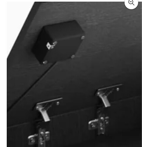

It looks like the RFID lock mechanism is just attached to the bottom of the lid. Maybe you could move it to the drawer?
Pretty cool and good spotting.

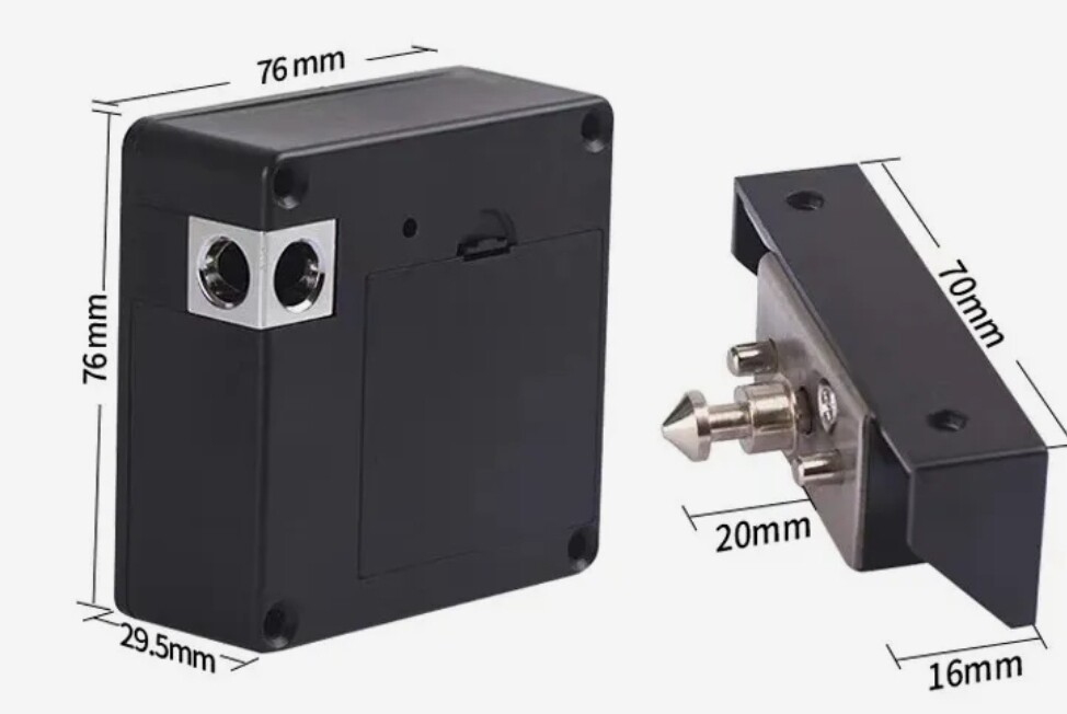

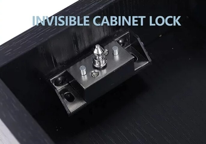

looking at the lock, it looks like a Rothult or more likely a chinese knock off, of which I have many.
Your nightstand
And the Chinese lock
In my experience, they work with Flexies, with contact on the surface, and you may get a very occasional read on an xSeries.
However going through ~15mm mdf, I would rate you chances pretty low.
The thing you have in your favour, is the fact it is mains powered, rather than my experience with battery power.
The antenna likely mounted to the underside of the lid and may be extended.
You could of course recess it into the wood by routing it out to wafer thin.
For you sake, I hope I am wrong
Good luck, Iook forward to your findings

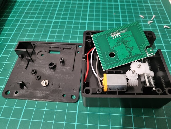

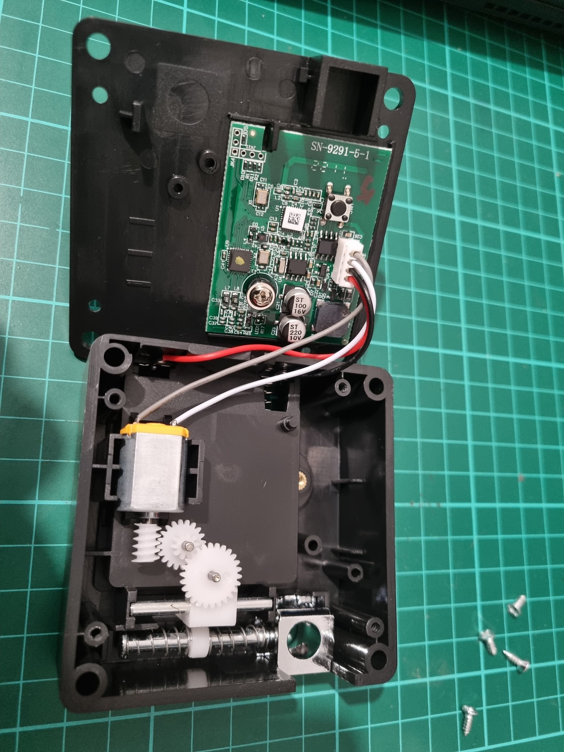

I opened one of mine up so you can see what to (possibly) expect
You can see the antenna that is mounted to and sits under the lid
Thanks. Does this unit have wifi or Bluetooth connectivity? That L-shaped trace on the component side of the board sure looks like an antenna.
Good spotting chap. :+1:
That particular one DOES have Bluetooth.
its a TTL Lock, so uses the same app as the Door lock I tested
Other ones of the “Rothult” style that I have do not have bluetooth or WiFi

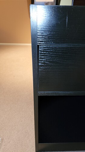

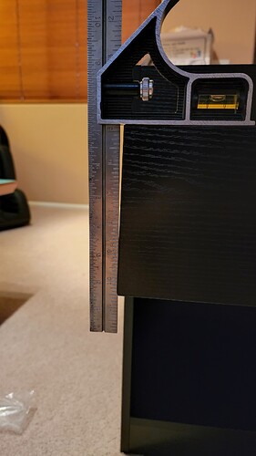

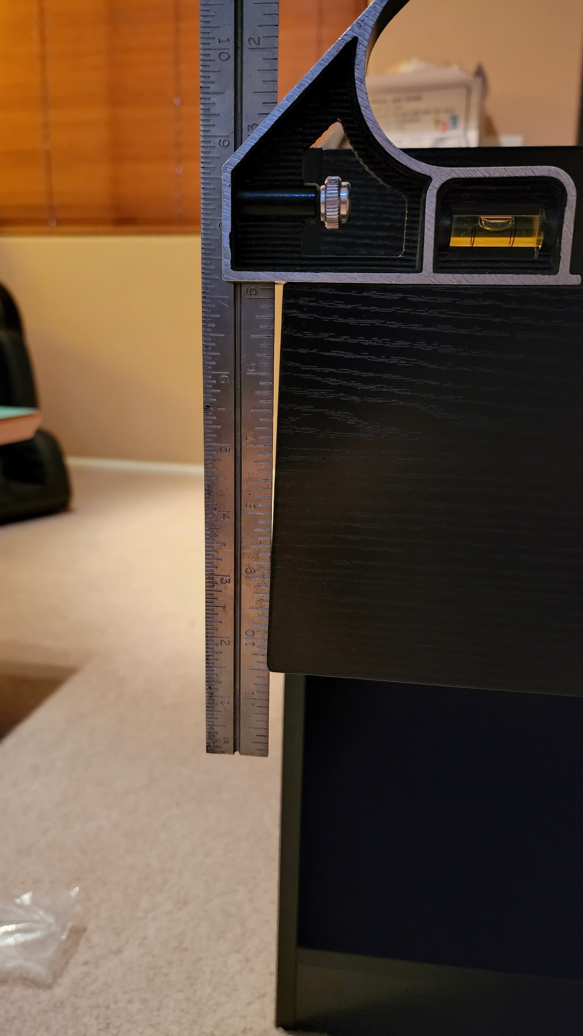

Sooo, as expected, this this isn’t worth it’s weight in saw dust.
Check out these tolerances.
Comes with the reader and some RGB LEDs. Both have USB for power. I guess you are supposed to use the only two USB slots they give you…the ones on the side that are supposed to be used for charging your phone.
As @Pilgrimsmaster called it, the read distance on x series is about 3mm. Never going to get a read through the MDF. Oddly the instructions seem to indicate to put batteries in the unit AND plug it in which seems odd. They do not provide batteries.
I thought maybe I could just interface a xAC to the existing lock, but then I’m reminded about how bad the rest of this thing is. Well really it’s just the drawer and the lack of power though the latter could be corrected easy enough. The drawer front that is so obviously out of square is not so easy to fix, and of course it’s the most obvious part of the thing other than maybe the top surface.

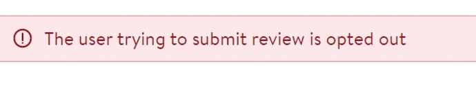

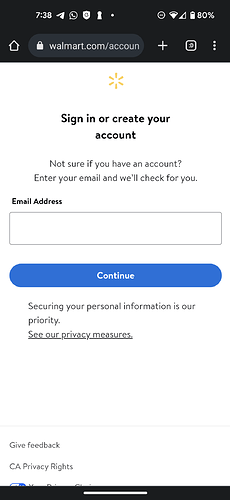

When I try to leave a review on Walmart… whatever that means.
Oh shit customer service tagged your account as a troublemaker so you can’t comment or review!
I know “some” of the “Rothults” can have an external battery pack for ? longevity? and and emergecy power to prevent lock out.
I guess, the plug in suggestion is the equivilent purpose of that
Probably has a hurt feeling filter, and didnt like you writing a negative comment.
:snowflake:
Hahah, I took the word “dumb” out and changed it to a 5 start to test and it still denied me. I even have the “send me review reminders” option checked in my account. Maybe I just need to wait for that email. lol
