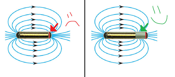

Just guessing, but the issue stems from the axial pull “snapping” the magnet into the glass tube end, correct?
Could you cushion it somehow?
Maybe an expanding foam that could be activated after encapsulation?
Basically if you could fix it, then hell yeah.
But the ethics of putting a known defect out there… :nauseated_face:
Is there a way to bring it back to satisfy that demand but also make it safe in the process?
What if the glass capsule was longer? This way the field lines wouldn’t line up with the weak spot on the glass.
Put a spring on either end in the empty space and turn it into a generator :grin:

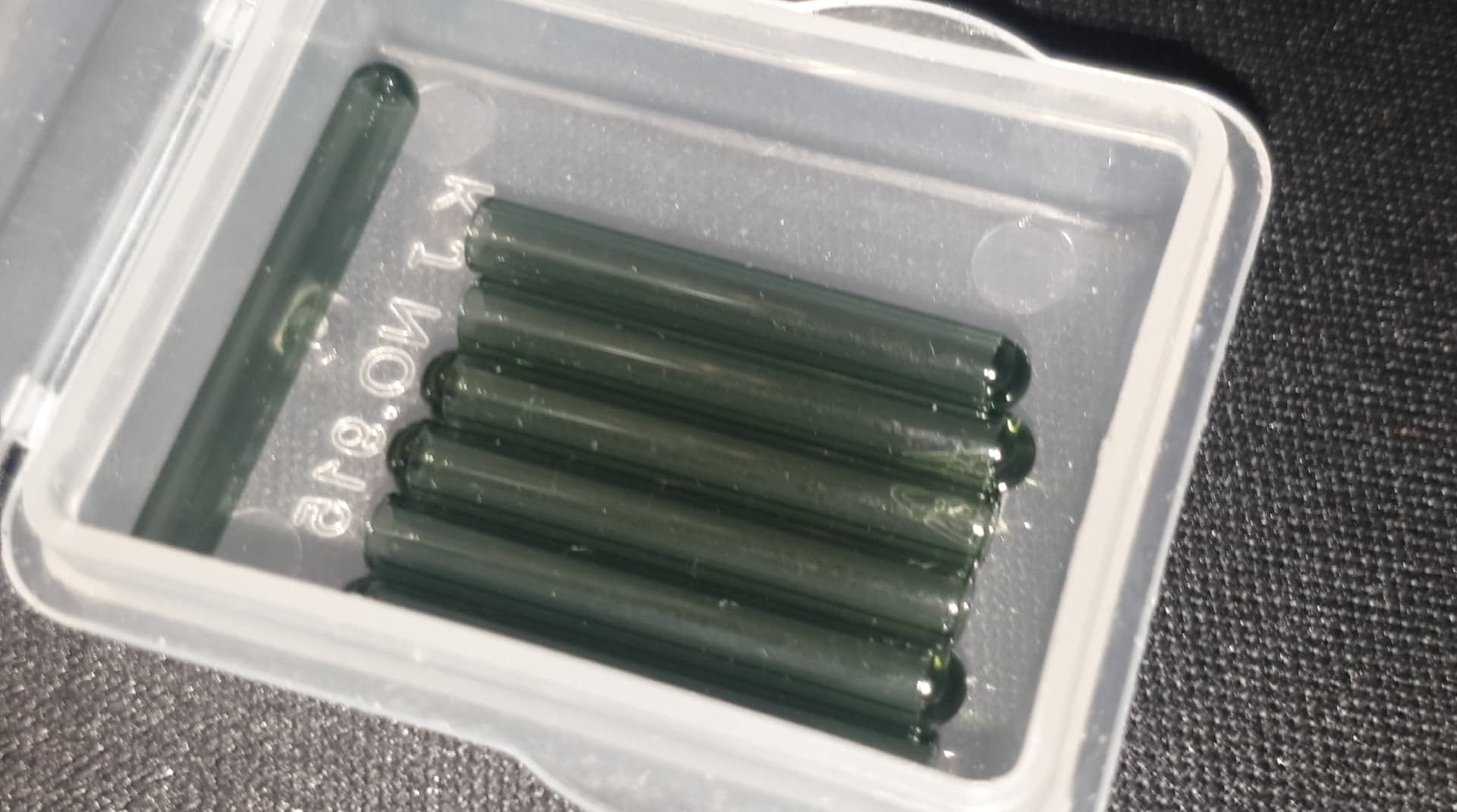

honestly if you want to play around, you can just get borosilicate glass
The way to seal these is by flame, but if you want it to be implant safe, a hydrogen + oxygen flame is used for this because hydrocarbon based flames infuse the glass with impurities. there are “browns gas” generators used for this which basically create and store small amounts of gas on demand for this purpose, and have a small jet nozzle you use to direct the basically invisible flame at the glass.
I purchased one of these to play around with, but since we don’t use flame sealing and I’m basically afraid of it exploding in my face, I’ve never powered it up.
Here you see me using a co2 laser to melt the glass, flame sealing is cheaper though^
Lasers do not work on borosilicate glass.
Why?
