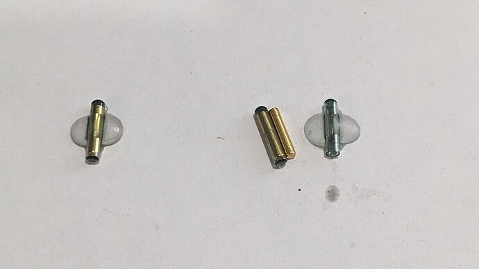

Well it happened. I pulled back the loose magnet and let it go and the cap just popped right off this one… pulled the magnet inside right out. The epoxy was probably shaken loose with the previous 50 or 100 hits prior to this one. I was kind of shocked but ultimately expected this in the end. Still, I’m impressed with the resilience.

Has there been any reports of the v2 failing in a similar fashion?
FYI
That was just under 2 months ago
Although the v1 has been around longer than the relatively recent v2 so the comparison is not statistically perfect :wink: presumably there haven been mayny more v1’s around for longer
