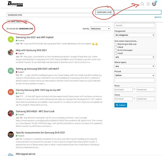

Have a quick search and readup on the 3321 here on the forum, so you can have a plan on what to try if you order them.
