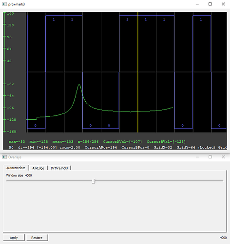

I’m trying to clone an Indala card using the proxmark3 onto my NExT implant, but haven’t had any success. Its a low frequency card. The only out put I can get is from the commands below. The second one below seems to be a valid ID but when the ID is cloned to a T55xx chip it doesn’t work. The detector wont even read the chip.
Any help would be appreciated.
pm3 → lf search u
NOTE: some demods output possible binary
if it finds something that looks like a tag
False Positives ARE possible
Checking for known tags:
[-] No known 125/134 KHz tags Found!
[=] Checking for Unknown tags:
[-] no repeating pattern found
PSK1 demoded bitstream:
1100111010101111
1111111111111111
1111111110100110
1000011011100110
1100111010101111
1111111111111111
1111111110100110
1000011011100110
1100111010101111
1111111111111111
1111111110100110
1000011011100110
1100111010101111
1111111111111111
1111111110100110
1000011011100110
1100111010101111
1111111111111111
1111111110100110
1000011011100110
1100111010101111
1111111111111111
1111111110100110
1000011011100110
1100111010101111
1111111111111111
1111111110100110
1000011011100110
1100111010101111
1111111111111111
11
Possible unknown PSK1 Modulated Tag Found above!
Could also be PSK2 - try ‘data rawdemod p2
Could also be PSK3 - [currently not supported]
Could also be NRZ - try 'data nrzrawdemod
pm3
pm3 → lf indala read
pm3 → lf indala altdemod
Recovered 909 raw bits, expected: 937
worst metric (0=best…7=worst): 1 at pos 2
UID=0000000000000000000000000000010110010111100100011001001100010101 (597919315)
Occurrences: 14 (expected 14)

Strange. Looking at your client’s output, it almost looks like an unknown type of tag.

Well, this doesn’t seem to be a cloning issue. Rather, it seems you might have hit a PM3 shortcoming. You should be able to get a solid read out of the original full-size tag - and you don’t.
If I were you, I’d hit the Proxmark forum and ask for advice there to identify the original chip, and/or work out what’s not working.
At any rate, don’t program anything in your NExT until you get a proper, reliabile read out of the original: no sense in tempting the devil.
