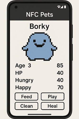

Meet Borky

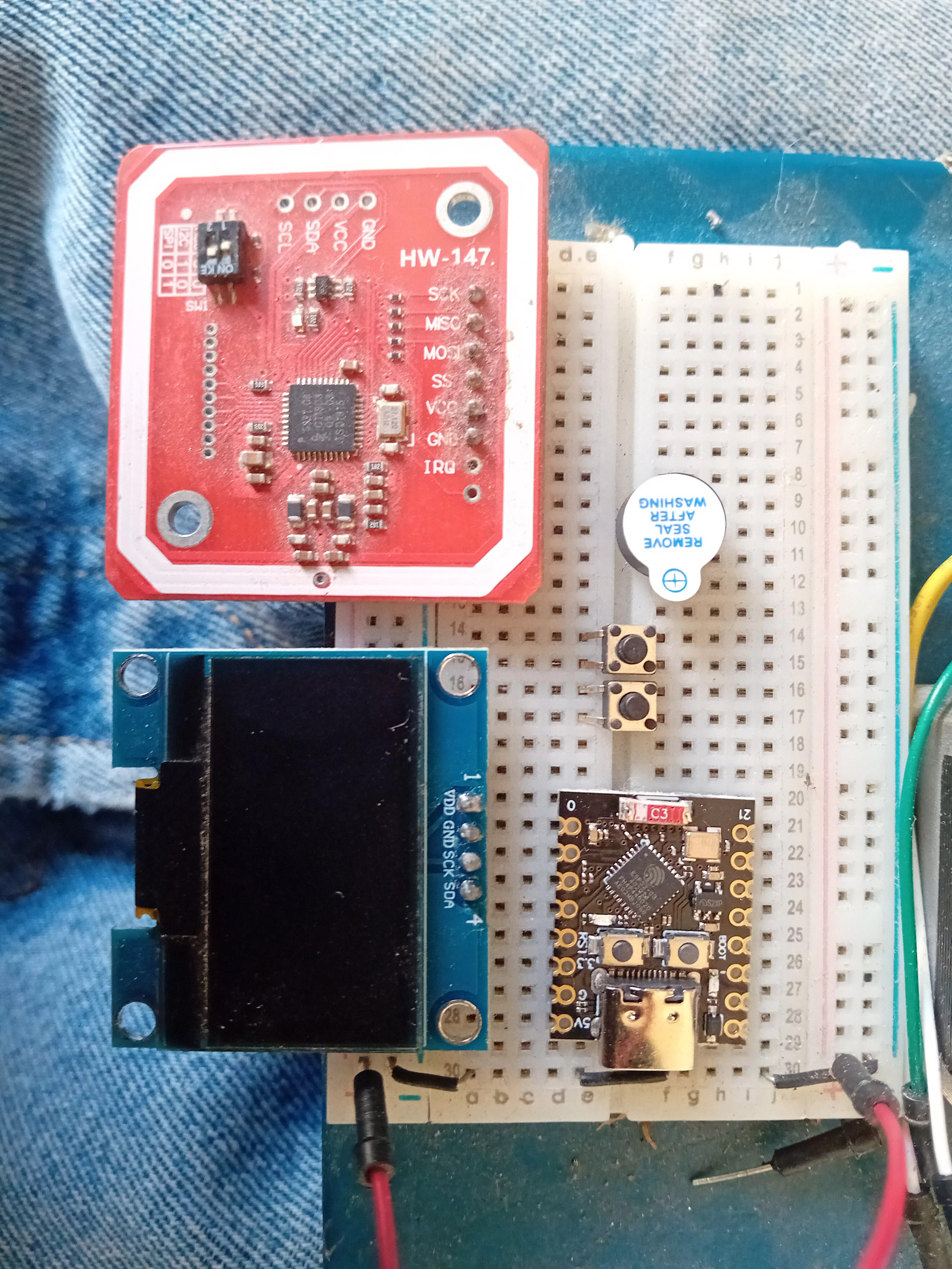

Update. Just testing hardware. Before i start the framework. For once i had all the components i needed. Feeling cute may add a RTC later for degradation purposes…

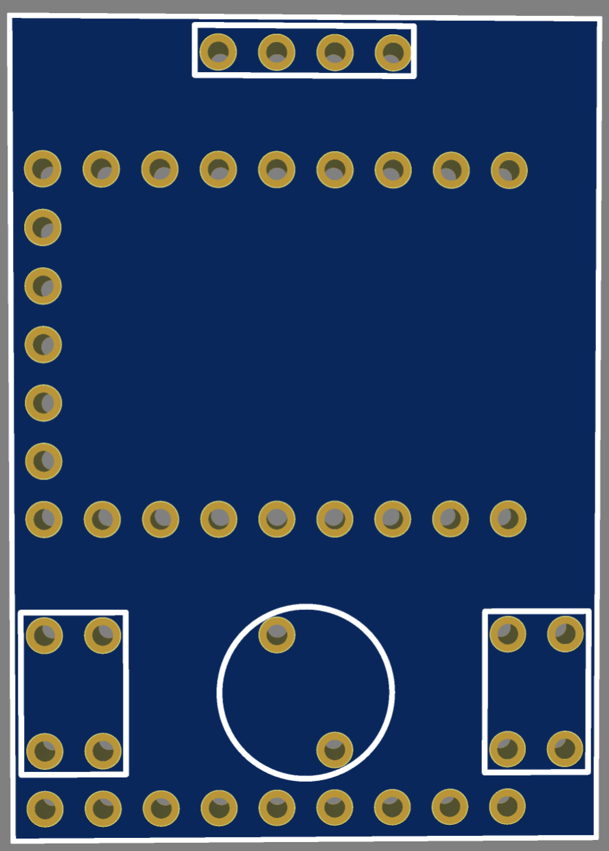

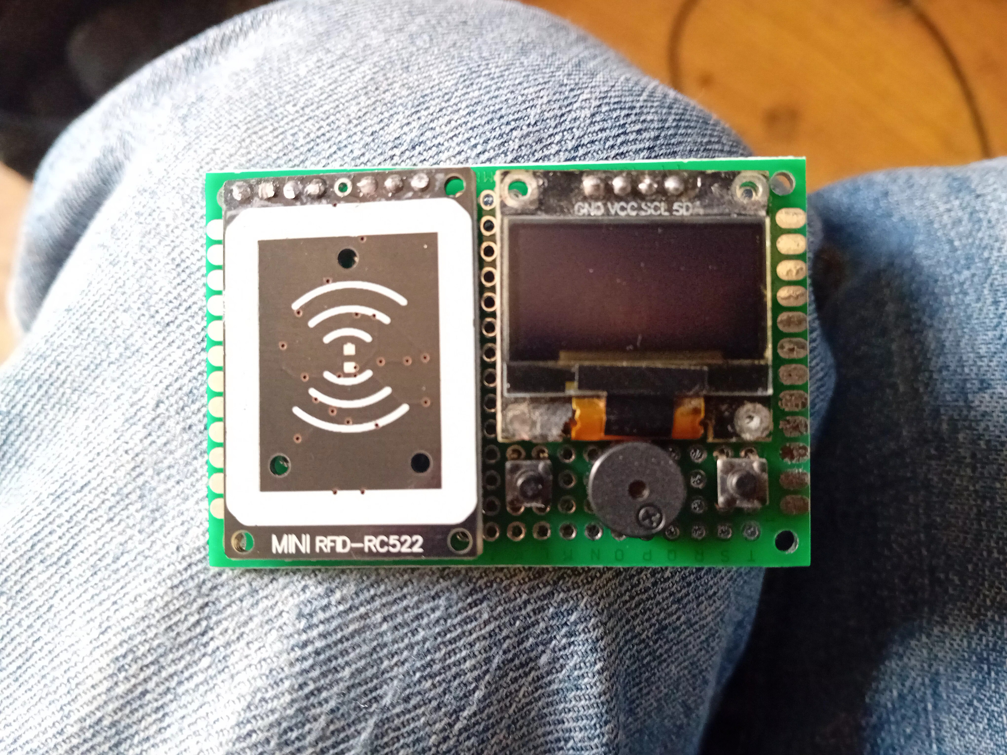

Had a little play with the hardware today thinking about how it will all go togeather. I am considering reverting back to the rc522 mini as it will all fit nicely and make a small unit
then knocked up a pcb,
