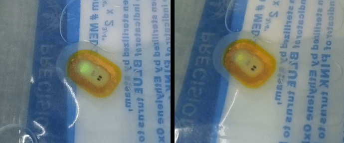

And now for what caused the largest commotion here: The blinkies!
I decided to test them by charging against multiple readers. Light is great on them all. All 5 chips are strong and working nicely!
Then I decided to test the glow strength.
Instead of comparing them in the dark, which would be optimal (and my camera would hate), I decided to test the glow levels on a bright environment, during day and with lights on.
This decision is to give me a better Idea of what to expect considering they will be under my skin (which should eat away a lot of the glow anyway), and to guess how long would they still be visible after I turn my necklace off.
It’s not a direct test, but gave me a good Idea of what to expect.
First test:

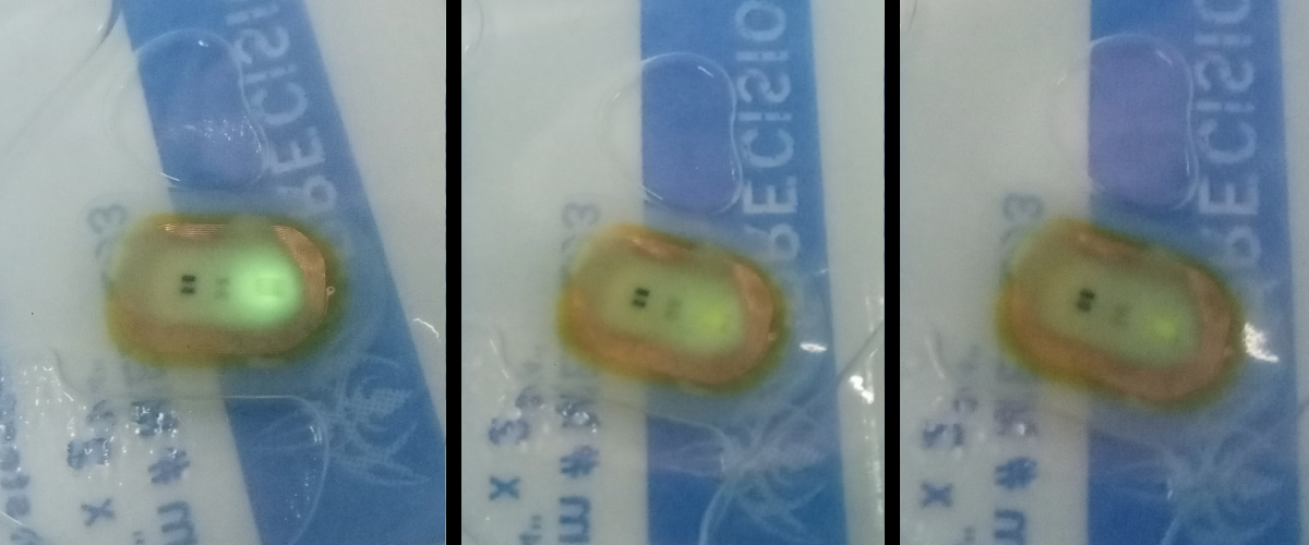

Second test:

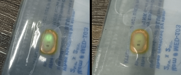

Third test:
  • left, immediately after 1 hour on the reader/
  • middle, 30 minutes after
  • right, 1 hour and 30 minutes after the first photo
Glow decay looks way faster due to my shitty camera and the daylight conditions.
It does retain a faint glow for a long time, though.

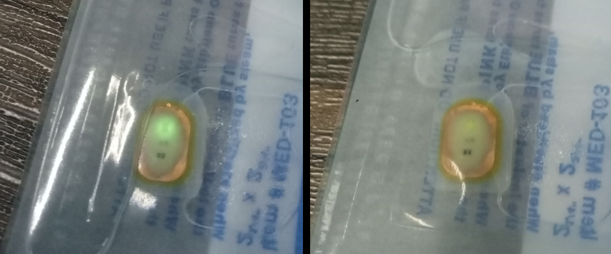

now, 4 hours later, the 5 second exposure one still has a faint glow on the dark.
Really curious to see how they show up once under the skin!
