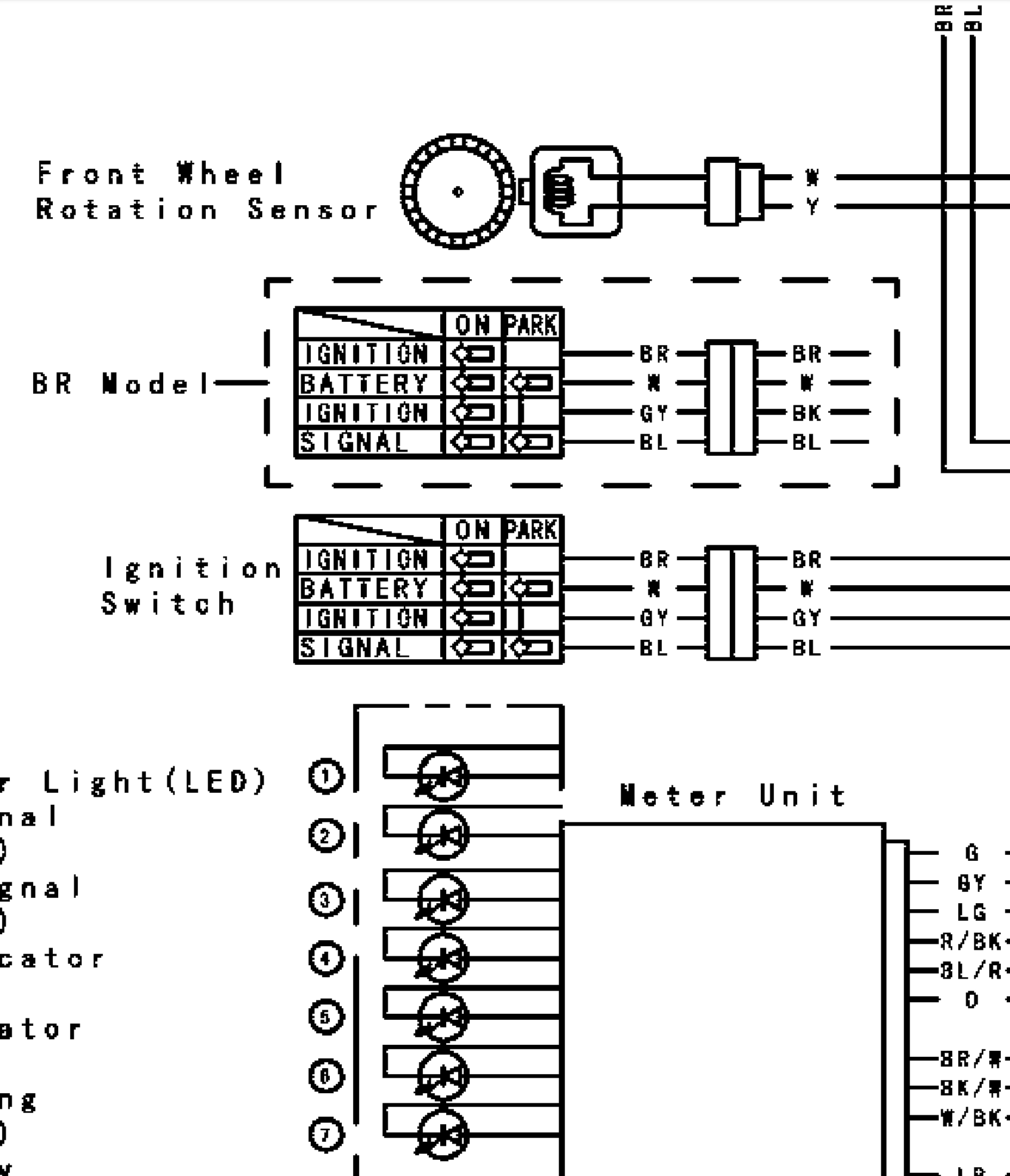

Below is the wiring diagram for my ignition switch, I would need to feed the 12 volt power to the three wires that aren’t the battery correct?
If unsure. Unplug igition barrel and check continuity using a volt meter in the on and off position. Also check for any resistance. (Some install crude resistors to make hotwiring a ballake.)

I meant to include this in the OP:
The signal line goes to a few relays for turn signals/brake/plate lights.
One ignition line goes straight to the ECU.
The other ignition line energizes the engine kill switch.
Never would have occured to me to check resistance there, I didn’t realize that was even something they did to try to prevent hot wiring.
That’s awesome, but stop giving me ideas! ![]()
