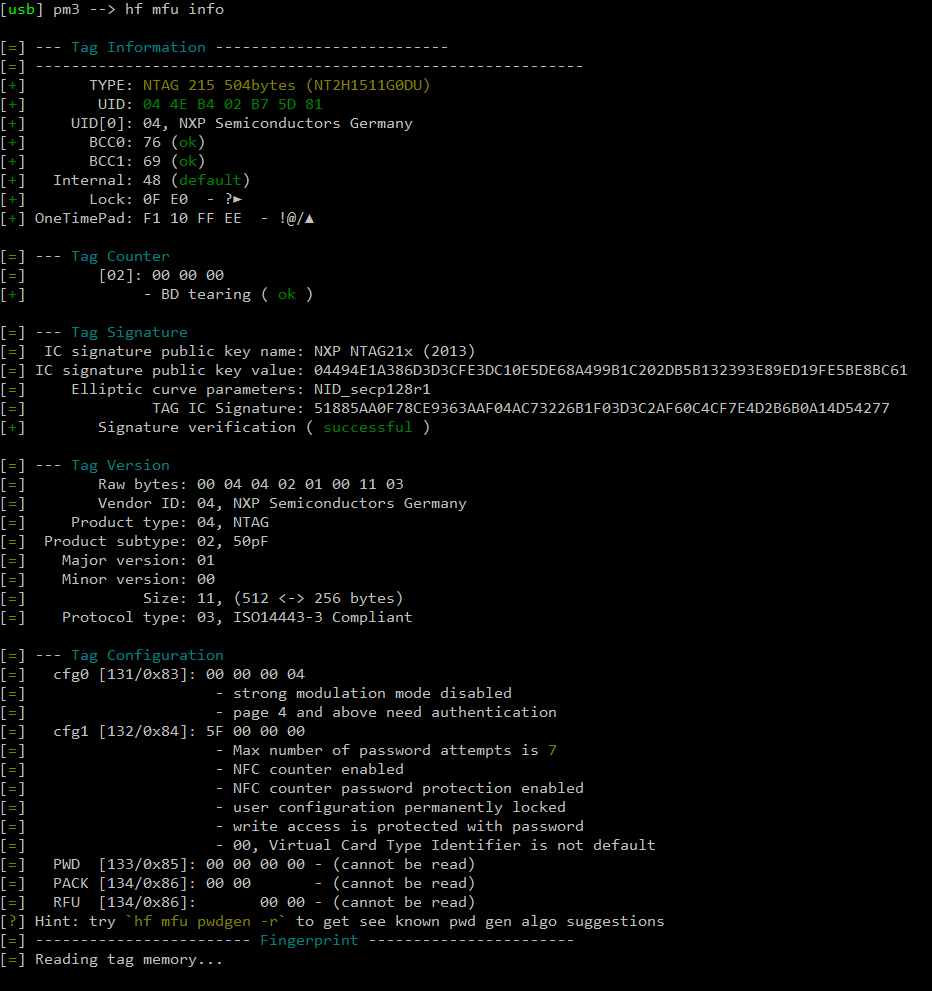

Ok so, I did a lot more testing. I read/wrote/cloned/emulated the n2 elite, “normal” NTAG215 cards with amiibo data written to them, and standard amiibo figures. The good news is that I’m 99% sure that the flexMN can handle writing/rewriting of amiibo just fine. I can’t be 100% certain unless I had a test card of course, but those are £26.99 over at ksec, which is more than I’m willing to spend on this right now. (Side note before I get into the other stuff: it was surprisingly super simple to emulate an amiibo with the pm3 easy. It makes sense, I just had never thought to do it before.)
Where things got super interesting was with the actual n2 elite itself. Here’s an example of the output of hf mfu info with a normal amiibo figure:
Amiibo Figure

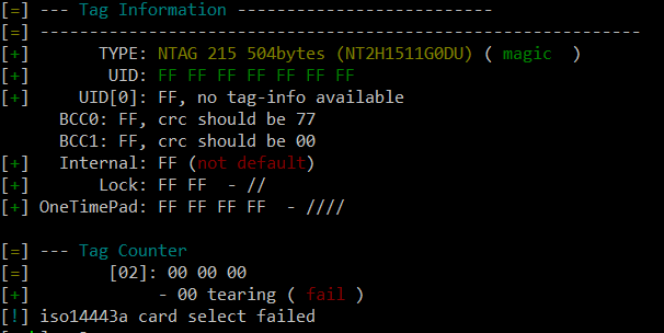

And here’s the output of the n2 after I wrote a dump of said amiibo to it:
n2 Elite
As you can tell, it fails pretty quickly. I’m curious if that’s because of the magic ntag, or the other stuff inside the n2.

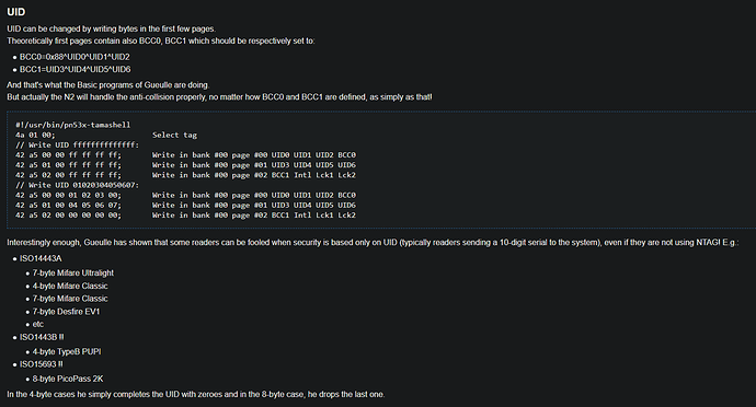

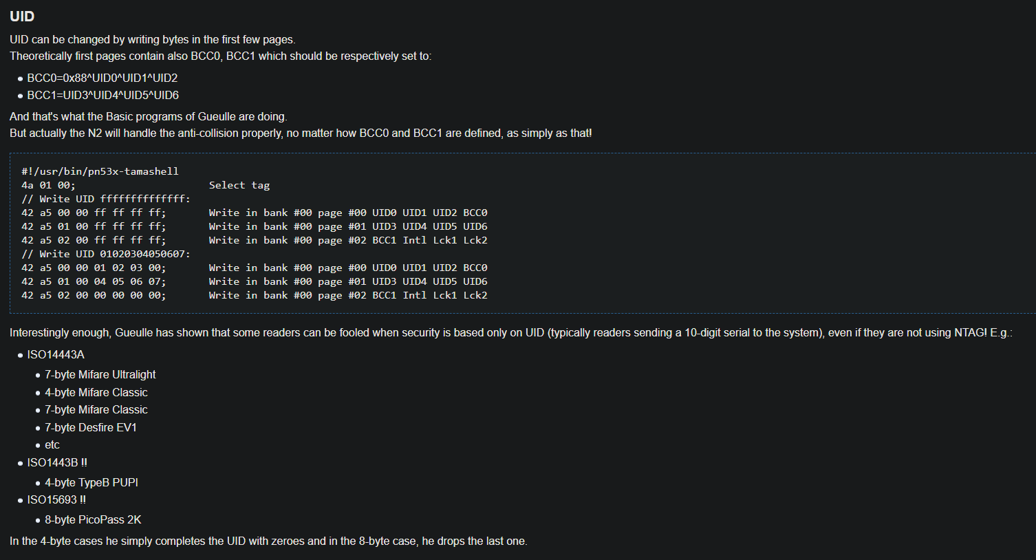

One of its selling points is that the n2 can store up to 200 amiibo at once, and swap between them on the fly either with an app, or the physical button on the device itself. From what I can tell there’s no way to emulate that function at all on the flexMN or other magic ntags. The n2 has some other hardware inside of it that makes this all possible. I wasn’t about to take mine apart to check everything out from the inside, so luckily this person did it for me! There’s a ton of really cool and useful info on that page, but there were a couple things in particular that caught my eye:
Thing #1™
This is pretty cool! Imagine if you were in an environment that had UID-exclusive authentication. This little device would give you 200 banks of IDs that you could cycle through without any external devices needed. There are much better ways of accomplishing the same task of course, but it’s fun to think of how to use technology in ways that weren’t intended.
The other thing that caught my eye was a little note at the bottom of the page:
N2 doesn’t emulate any of the protections (OTP locks, etc) and everything is always fully RW
That’s pretty interesting. If I’m understanding this correctly, then either the n2 is somehow successfully spoofing amiibo without lock bits, or Nintendo doesn’t actually check those. That could potentially open up a whole new world of possibilities both in terms of getting amiibo onto an implant, and amiibo spoofing as a whole. I really know next to nothing about this stuff though, so I’m probably misunderstanding that sentence.
