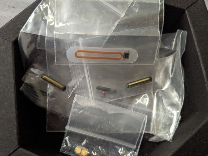

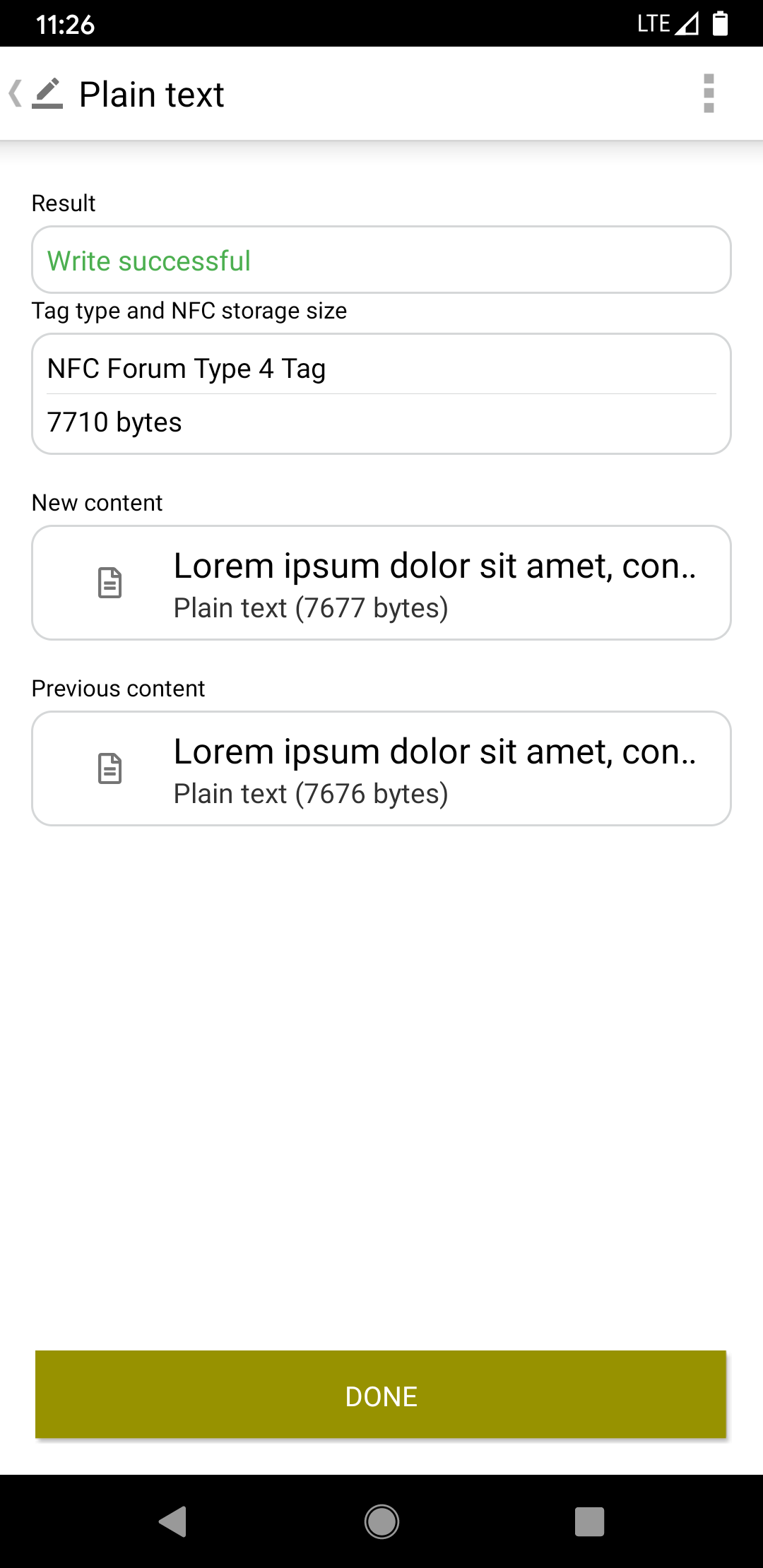

I was briefly upset that I couldn’t test this out for you because I no longer have a DESFire implant, but then I reached into my little box of removals and found my flexDF.
I tested it out and it can accommodate a maximum NDEF space of 7710 bytes which allows 7677 bytes of plain text. Not too bad if you just want to densely save personal information, especially if you had several of them.
Thanks man, I didn’t even think that someone was fighting here, it’s just that my English doesn’t allow me to reveal it :smiley:
Thanks for the useful information, I think 7710 bytes is even a lot.
