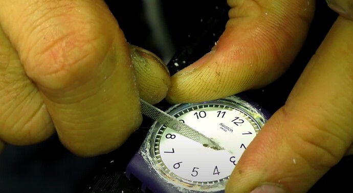

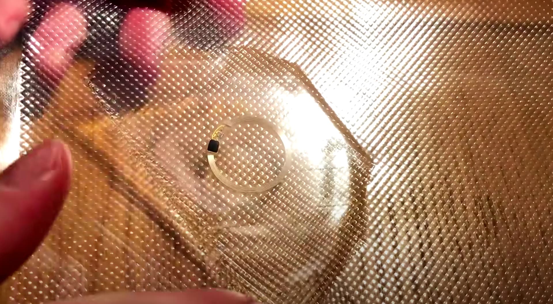

The topic is this, Recently on one (Russian-speaking) YouTube channel I came across a VIDEO about how a guy created a payment chip from a SwatchPaywatch and installed it in his hand.

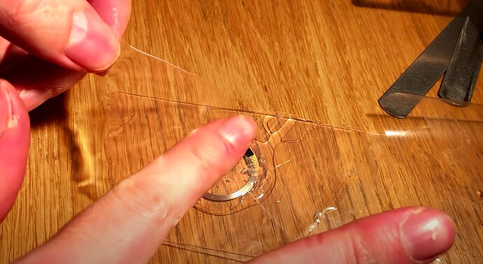

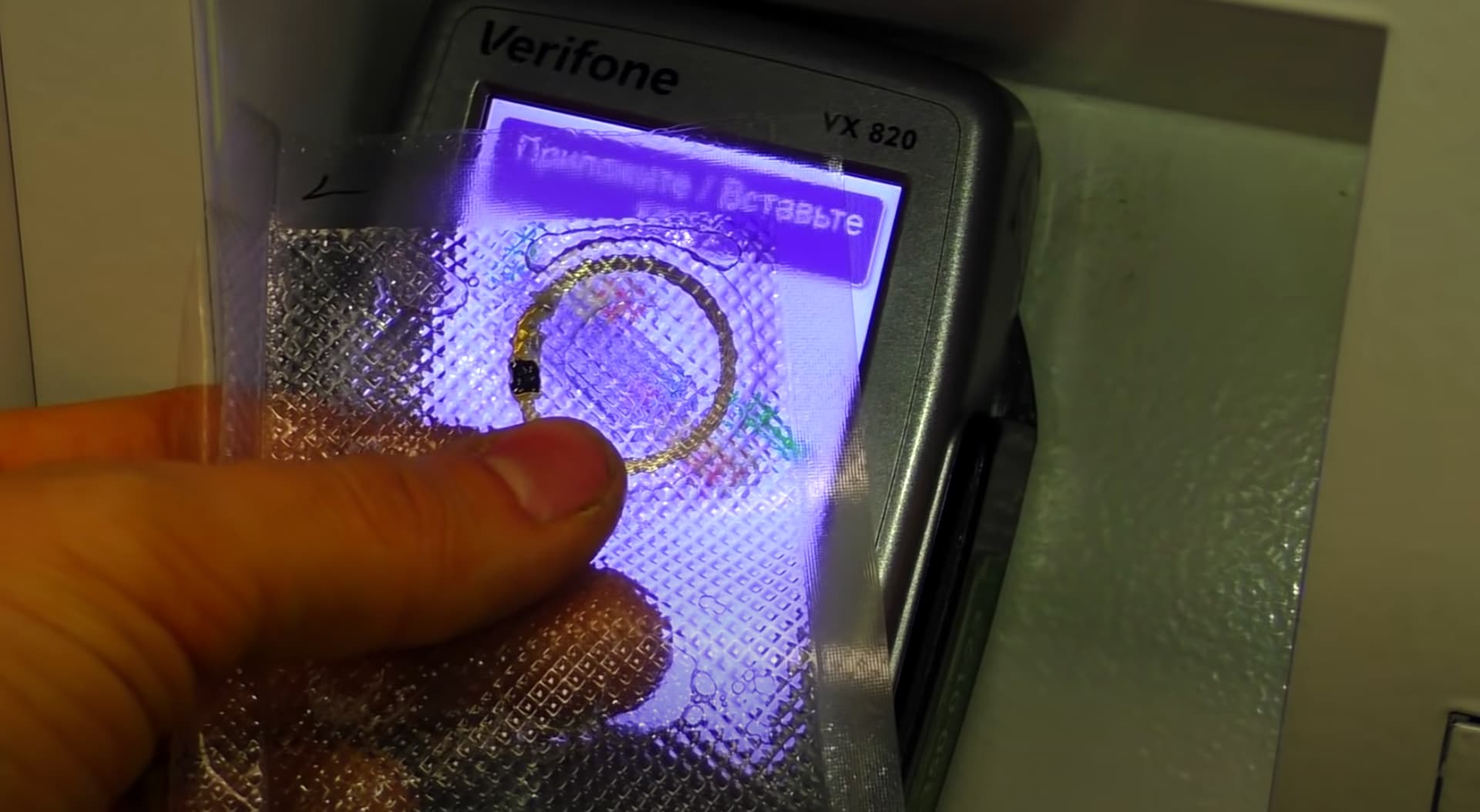

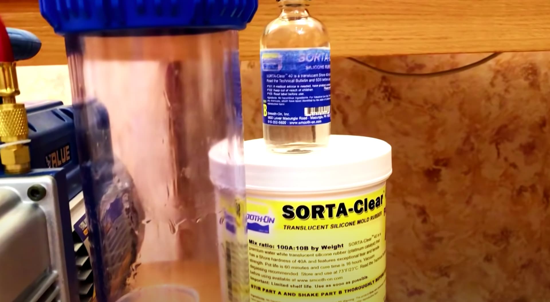

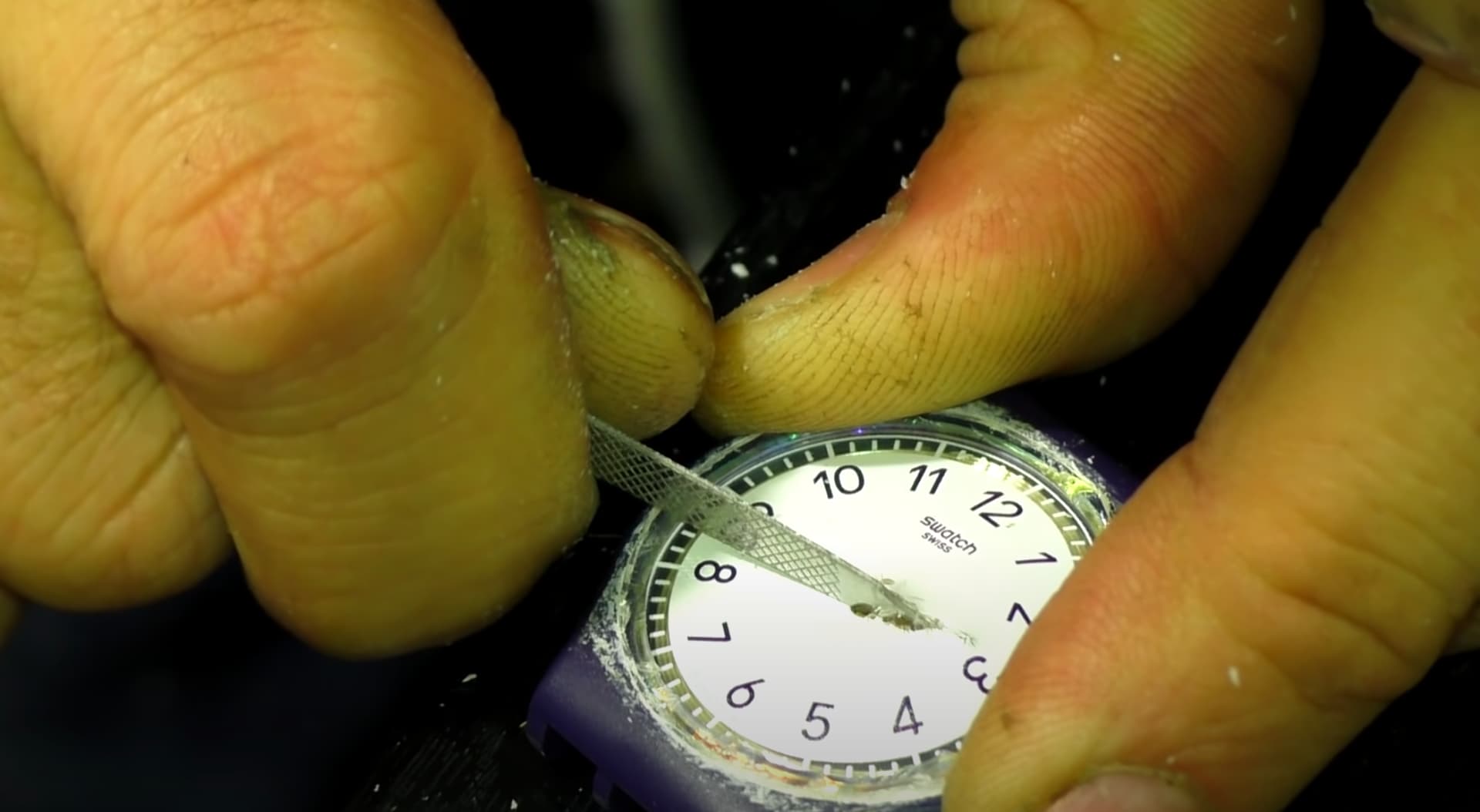

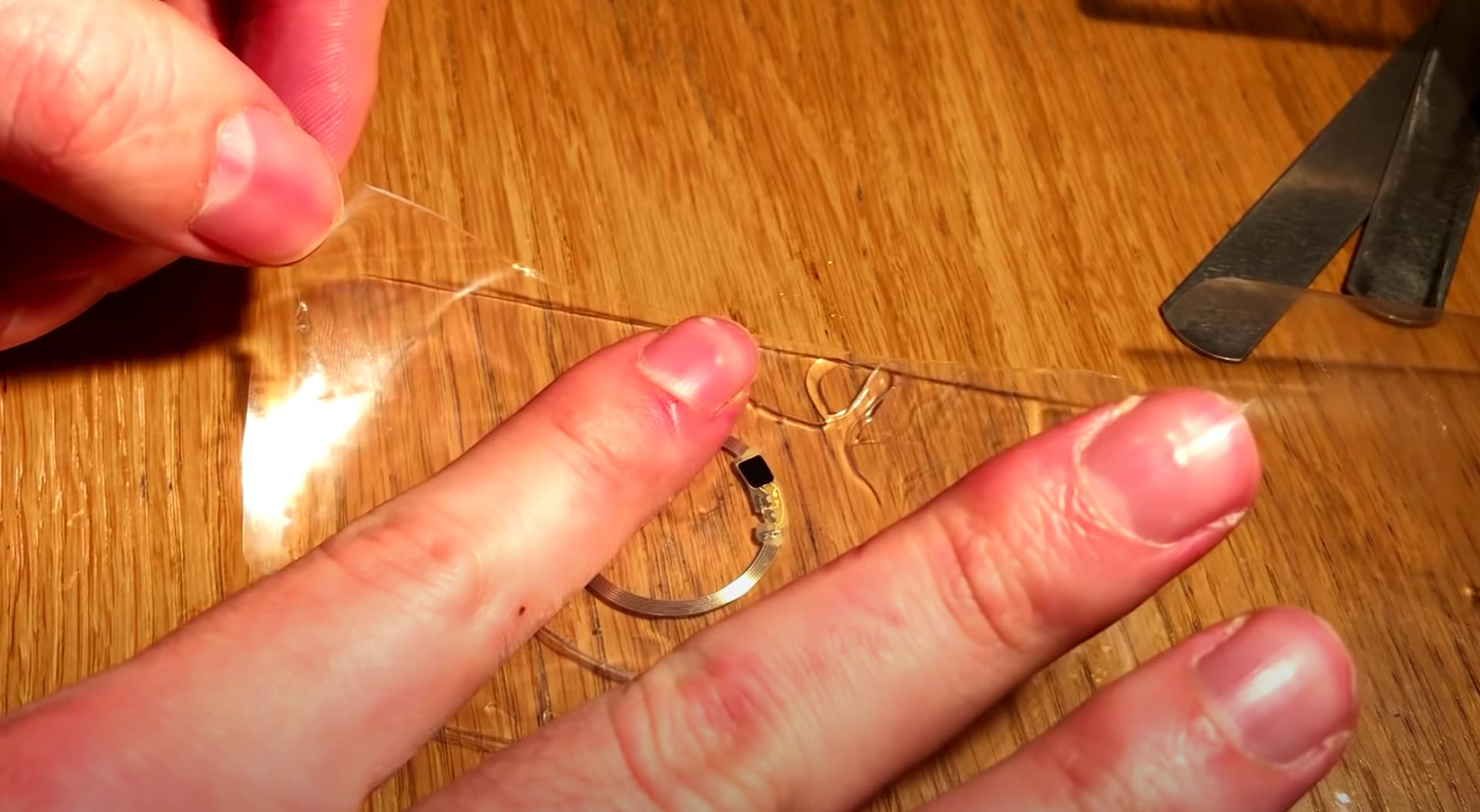

This biohacker actually did a very good job. Silicone is acceptable as an encapsulant as long as you remove the air bubbles with a vacuum like they did. I mean there’s minor criticisms, but overall great job. It may be possible to have this converted using the conversion service, but the PCB that the chip is on might be too tall in the z-axis.

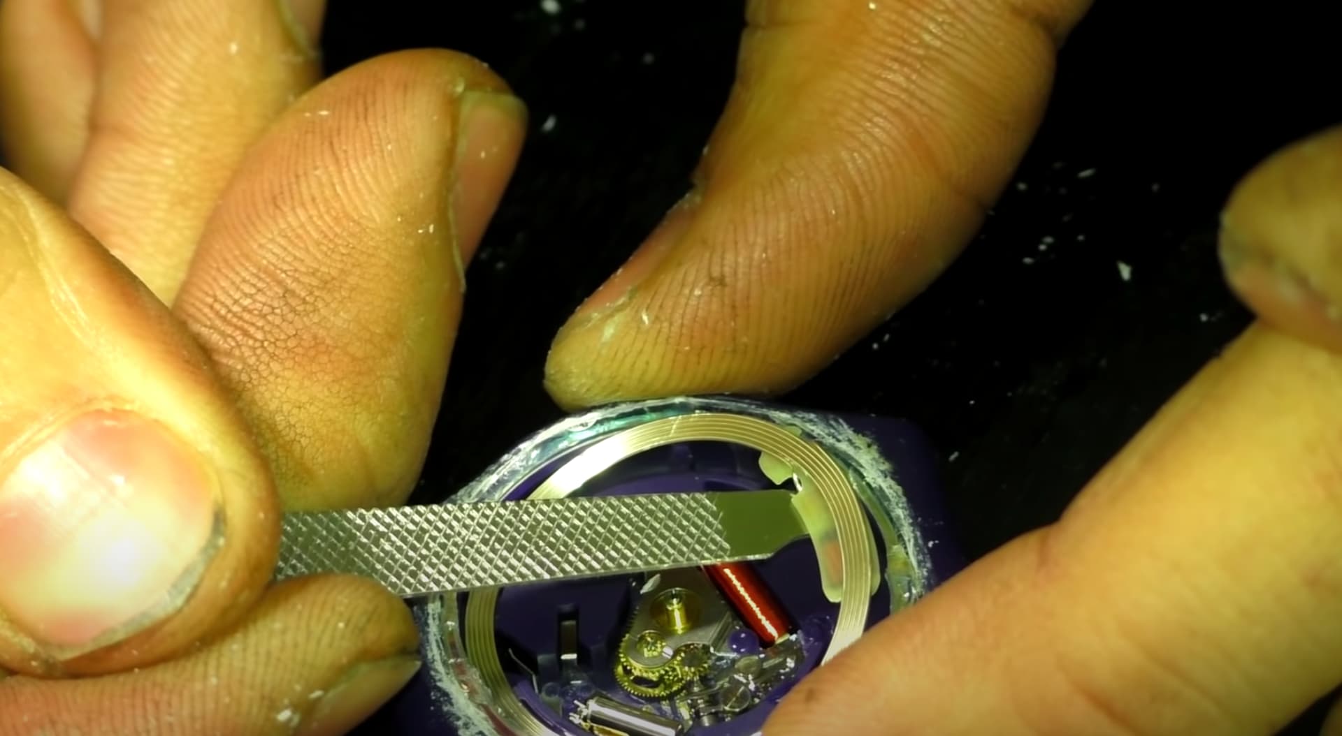

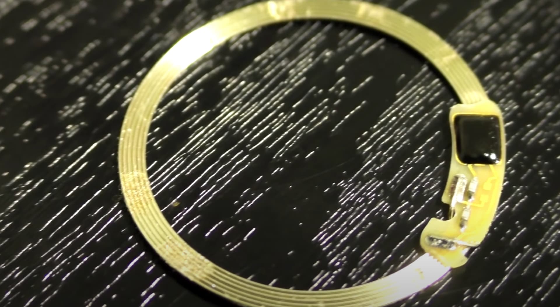

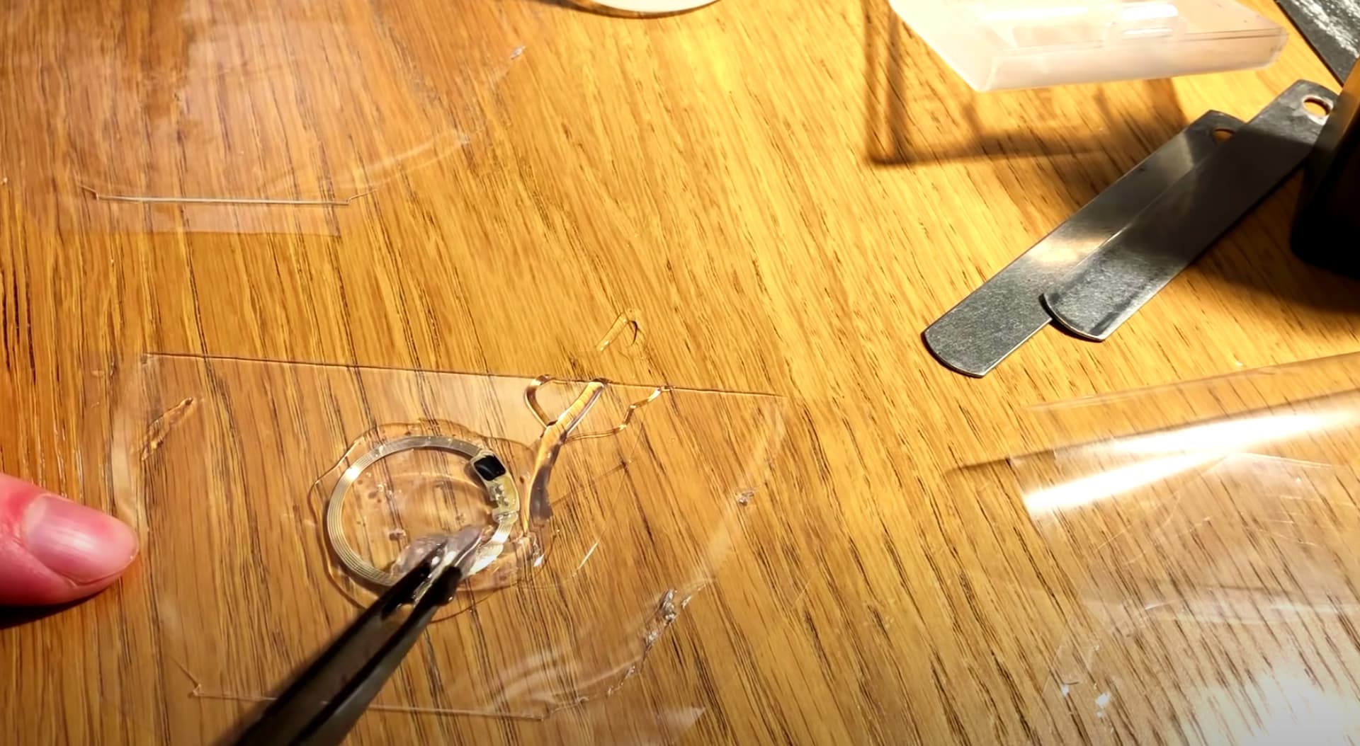

Full disclosure I’m one of the guys at DT. Unfortunately the chip in the SwatchPAY cannot be removed and put on a replacement antenna easily because it is covered in black potting compound. The most likely way this is going to work is encapsulating the entire round assembly as it is in the video.

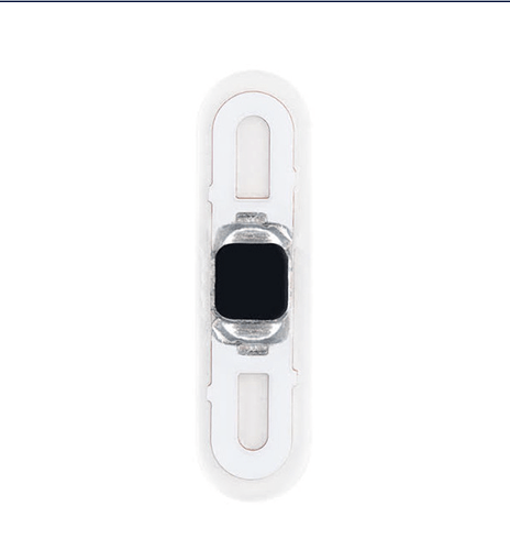

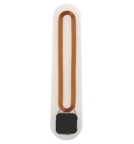

If you want a full conversion down to the standard flex form factor, you’re either going to have to take one apart and send plenty of pictures, or send one my way for destructive testing.

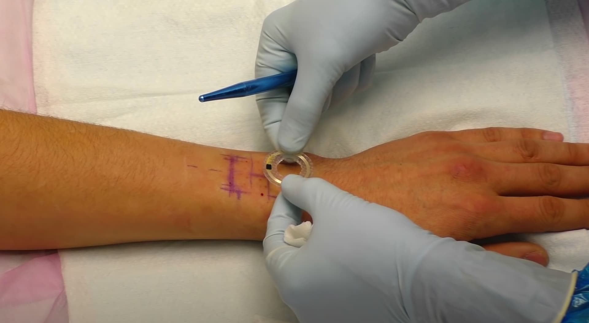

What do you think, maybe the antenna can just be squeezed? so that the implant becomes narrow and not huge and round?
I plan to install the device on my left hand along the bone that goes into the little finger (I don’t know what it’s called), the form factor is very important in my opinion
The antenna can’t just be folded up into another shape, the shape is very important. I was thinking either the chip can be removed somehow with a solvent, or that the carrier board between the chip and the antenna can be soldered to a different, smaller antenna. I need to see pictures or examine one myself though. I’m not optimistic. It will probably need to be encapsulated as is with the large circular antenna

But a big antenna isn’t necessarily a bad thing though… in regards to certain terminals that hate me
The video showed him paying easily with all but one terminal, but that was due to the placement on the wrist “issue”, and the terminal being in a recess. It still worked, it just looked awkward.
On the back of the hand would have worked more easily for that terminal I believe.
