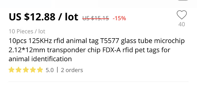

So here’s a dumb question
Trying to write to a cheap Chinese glass tag
(Not for implantation, possibly embedding in 3D prints or something)
I can’t seem to write or read the stupid thing
I actually busted out the field detectors to look, and the flipper has great field…
I figure there’s 2 possibilities.
It’s garbage, or not actually a t5577 / not rewritable
Or
I’m doing something wrong and missed something obvious
I’m assuming that whatever it’s set to, if I write to it … it should changed it to the format I tell it right?
It’s marketed as a pet chip using FDX-A, not sure if that’s actually a mode or not… but if I were to write to it, say EM or hid prox, it should become that right?
Or do I need to use a proxmark to change modes or something?
if it’s fdxA then it’s a read only (cannot write) chip. the flipper isn’t able to read FDXA at the moment
I’m not sure about the Chinese tag but the Flipper will write to the LF side of a NExT quite reliably. In fact I had failed to write it with my proxmark a while back and stopped showing up when trying to read it even with the Flipper. I did a write of a tag I had saved and now it’s readable again :man_shrugging:
So are there read only t5577? Or did they lock it or something?
Or is likely NOT a t5577 as claimed?
if it’s marketed as FDXA then it’s not a t5577
I know you can’t trust chinessium sites to be accurate but still, that’s frustrating then :roll_eyes:
do you have a proxmark you could use to scan for t5577?
I do, just not with me…
And it’s also no longer installed on my computer :sweat_smile:… so I need to do install it again
Cough @darthdomo cough cough cough
But back to the basics
If it IS a t5577 would then flipper change it to EM mode if I was writing an EM tag to it?
Or does it need to be in EM mode to begin with?
Or is it somewhere in between, it needs to be in one of the modes the flipper understands, in order to change it to the correct mode?
it can be in any mode as long as it’s not password protected
Hmm so maybe it’s password protected?
That’s weird… they claim it’s rewritable and everything…
