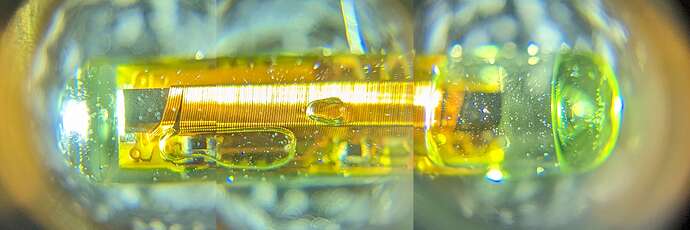

Let’s start with some closeups:
I was able to stitch these together from my DIY microscope:
The IC reads : “D21 1301 D035”
Can a pcb wizard give us an overview of what’s going on? I could easily take more shots if someone wants to map out the circuit.
That’s a QFN16, isn’t it? The only NFC chip that I could find on Mouser with that package is the NXP NCF3310AHN. There’s also a die sized chip on there.
Also, what did TagReader say about the chip?
Can I ask for the dimensions of that glass vial transponder? It looks rather large. And by the looks of how the glass was sealed, I’ve got the impression that it’s not even close to DT’s quality.
Dimensions: 13*3mm
The seal doesn’t look too bad in person. Part of it is filled but there are plenty of air bubbles.

looking in the closeup it appears to me like they sanded down the corners of the chip so it will fit in the tube.
Ahh, thank you comrade. I’ll take a look over the next couple days and try to get a schematic for ya.
