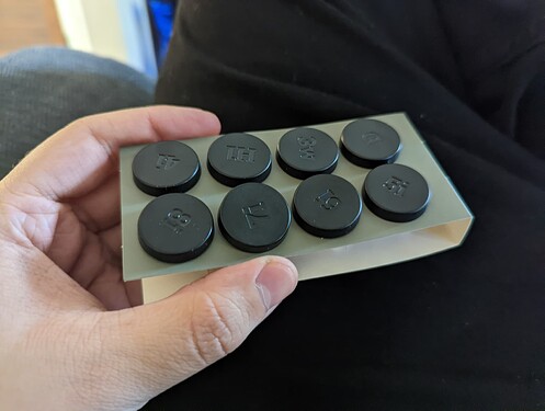

For Father’s day, I bought my dad a Shot Scope V3 golf watch. It works as a golf GPS, while tracking a ton of data about his golf game.
It has 16 RFID tags that come with it, to automatically track which club is being used. They screw into the top of the club, into the handle (most grips have a hole in the center).
They are indeed 13.56MHz, I did a scan with TagInfo, and they’re ICODE SLIX chips.
Here’s the full scan if anyone is curious:
