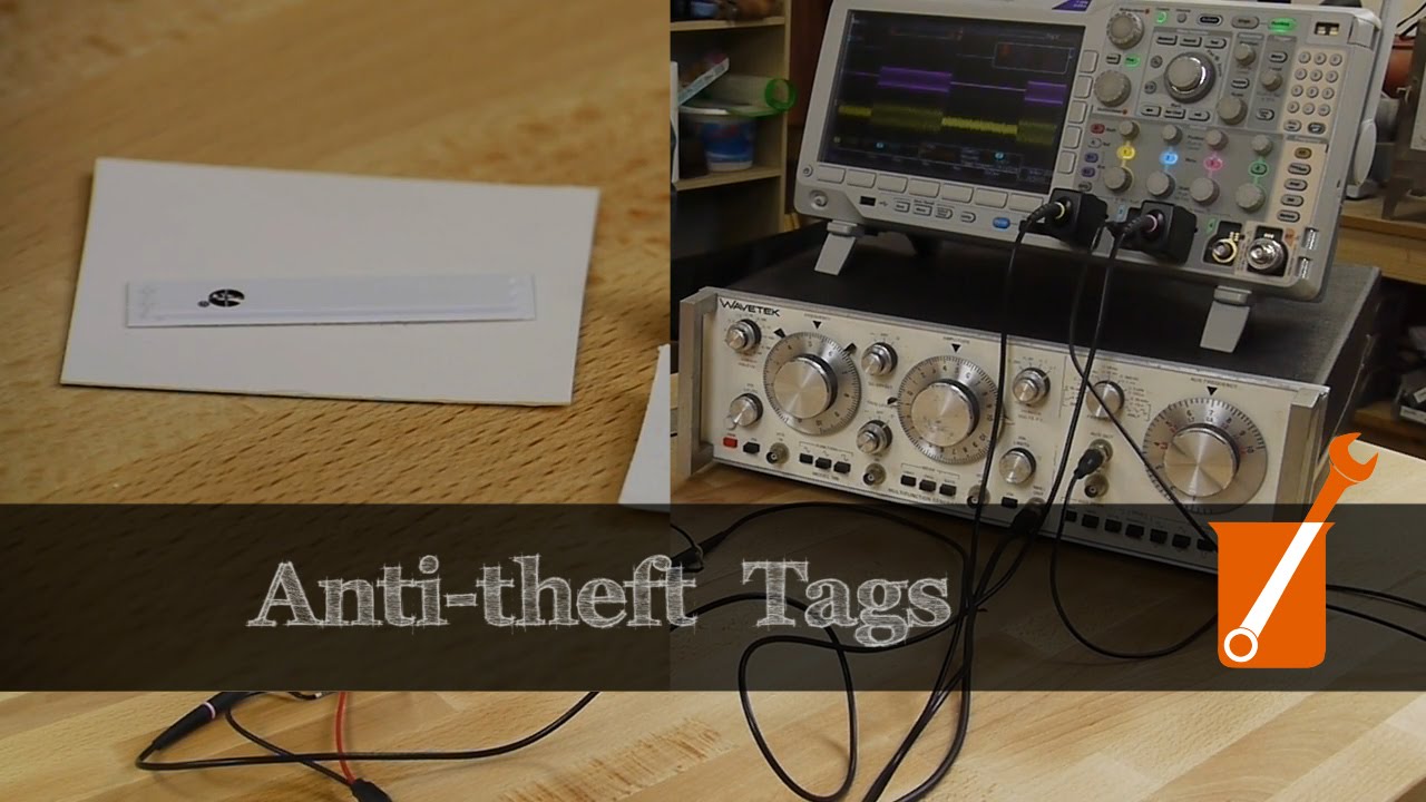

If you’ve ever wondered how those anti-theft tags work, when you pass through the portal at the store, whether they are RFID, RF, UHF… wonder no more: I found this cool video from Ben ā€œApplied Scienceā€ Krasnow (if you don’t know this guy incidentally, watch his videos: you’ll wonder how you went through school without him as a teacher):
It’s nothing to do with RFID - or it is, in a caveman sort of way - and it’s pretty damn interesting.
Actually not this part… these are called ā€œbit tagsā€ either binary 1 or 0, on or off… RFID tags are iso15693 and 13.56MHz that leverage EAS features (electronic article surveillance)… in fact we have to disable these features on the VivoKey Spark 1 or you might possibly be setting off badly configured antitheft systems in certain stores that use RFID tags for inventory control (and antitheft is part of that system).
