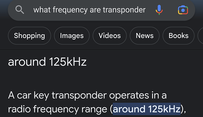

Ok so basically the problem here has to do with the word ā€œtransponderā€.. could be the passive immobilizer transponder embedded in the key body, could be the door lock control fob.. could be a ā€œkeylessā€ fob. Generally speaking, the passive transponder embedded in the key body is 125khz (usually a TI 40bit challenge/response system similar to HITAG), while the active lock control fobs operate between 280khz and 340khz.. typically.. but on the electric field not through magnetic induction like the passive transponder.
I’m more interested in the immobilizer side right now, so this seems to be good news
Appears I was mistaken :man_shrugging:t2:

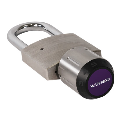

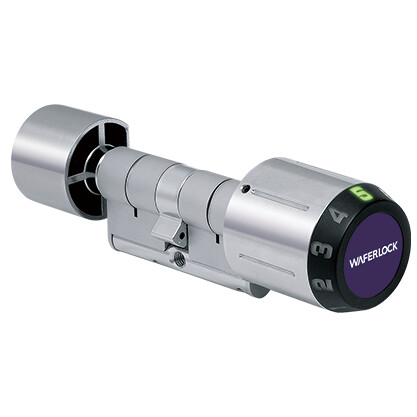

Some ā€œnewā€ RFID locks
Door Locks
Padlock (As reviewed by LPL and easily shim bypassed)
No further details
Just FYI if anybody is interested
The bottom wafer lock was featured very recently on LPL and is easily opened with a shim by pass.
