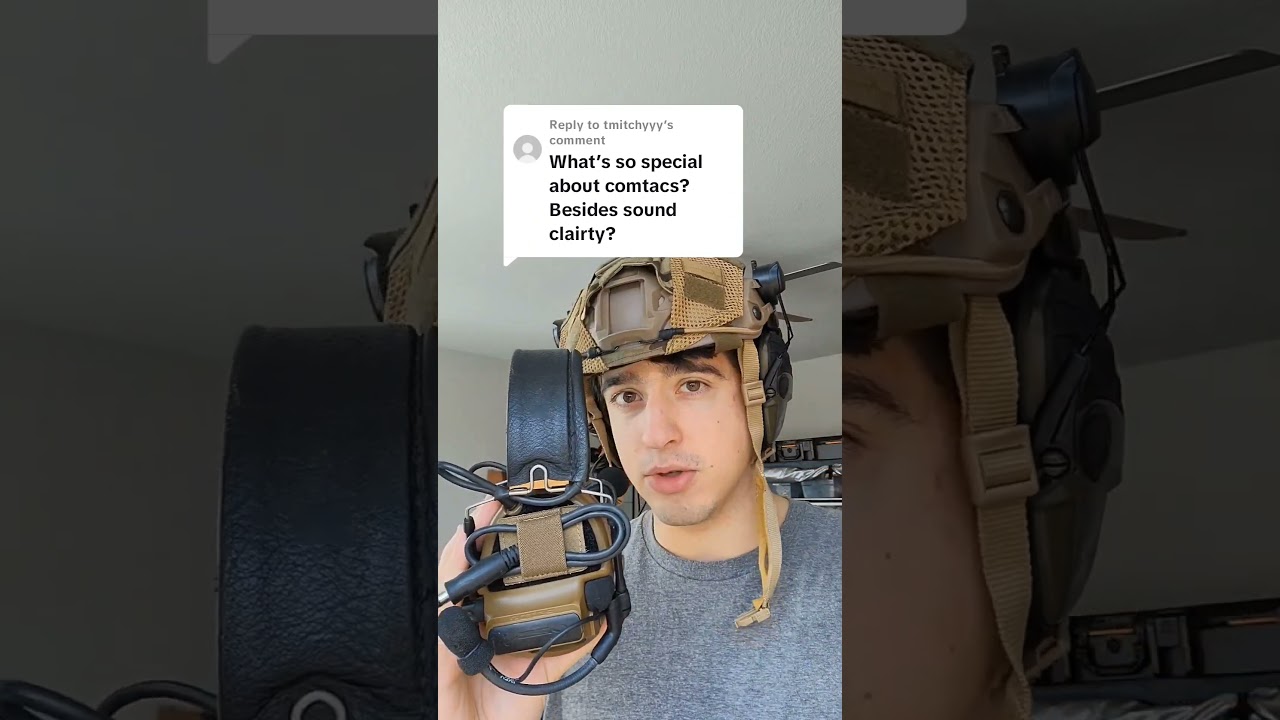

Ok, I have no idea about this but I came across a video about some military headsets or something and I noticed that the ones that the guy is holding in his hand have the same connector as most helicopters:
Are those compatible?

The plugs are most likely compatible with each other.
Most civilian helicopters have the same single plug. They are generally known as
U-174/U (Nexus TP-101), U-93A/U (Nexus TP-102) and Nexus TP-120; practically all the same and also known as US NATO.
Most military aircraft – both fixed wing and helicopter – use a single plug called a U-93A plug which is the same size found in a civilian helicopter (mostly U-174).
The ComTacā„¢ VI use NEXUS TP-120 plugs, so the plugs are compatible.
However, what can cause problems is the impedance (rabbit hole) of the headset.
Military headsets are generally low impedance instead of high impedance found in civilian aircraft.
In other words: Just because the plugs look the same, you shouldn’t expect a civilian helicopter headset to work in a military aircraft - or vice versa.
However, it is possible to overcome this problem by using headphone amps or adapters.
I’m pretty sure that the headset that I mentioned in my previous post is not designed for aviation. And I don’t know why there are so many headset connectors in aviation, why couldn’t we settle on the LEMO plug with panel power?
