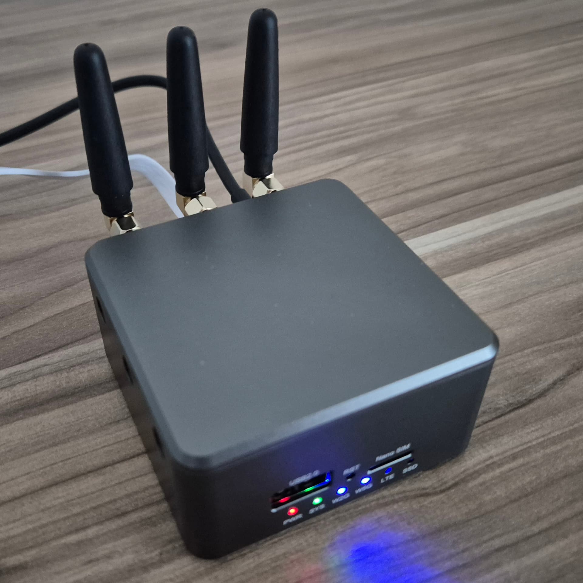

New toy:
It’s a Banana Pi R3 Mini, running vanilla OpenWRT. I’m not going to run the included chinese version.
Should I get an LTE modem for it or something?

Been looking at them for a possible pu project, are you thinking plug-in hat or stand alone modem through copper/wifi connection?

The SBC router thing that I bought has an M.2 slot for one. It only provides USB 3 so you have to choose a modem accordingly. There’s also a spot for a small SSD.
