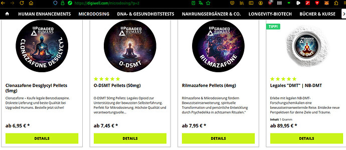

Digiwell (german DT RESELLER) is now selling fucking Opioids and Benzo derivates.
I knew about the DMT alternatives and other hallucinogens, but… Ew
