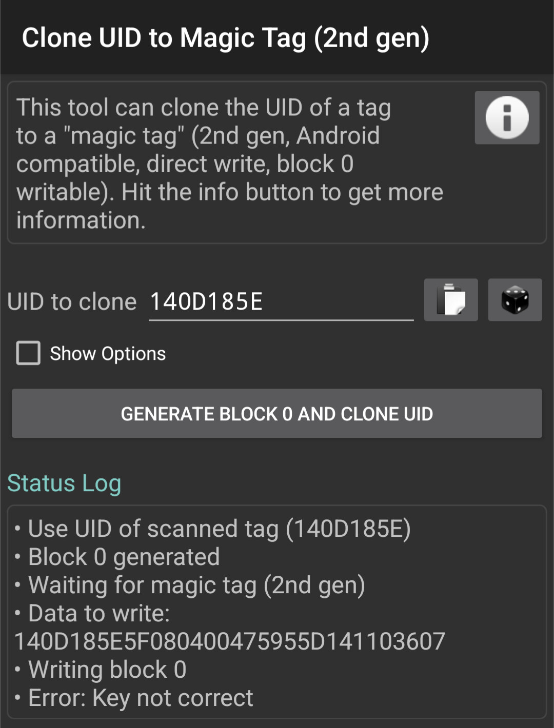

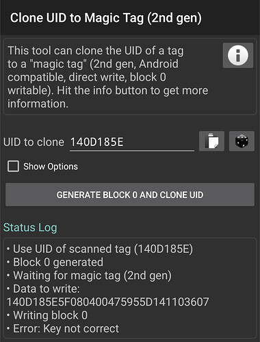

After changing the UG4 to 7 byte UID, i get this error in MTC
So i changed it back to 4 byte UIID and still get the error when tryin to wipe
[usb] pm3 --> script run hf_mf_ultimatecard -w
[+] executing lua C:\PM3\ProxSpace\pm3\proxmark3\client\luascripts/hf_mf_ultimatecard.lua
[+] args '-w'
ERROR:
[+] finished hf_mf_ultimatecard
and now :unamused:

hrm not a 7 byte then but the uid that was on it 04112233 is usually a placeholder 7byte.
ping me tmr ill have a go at it

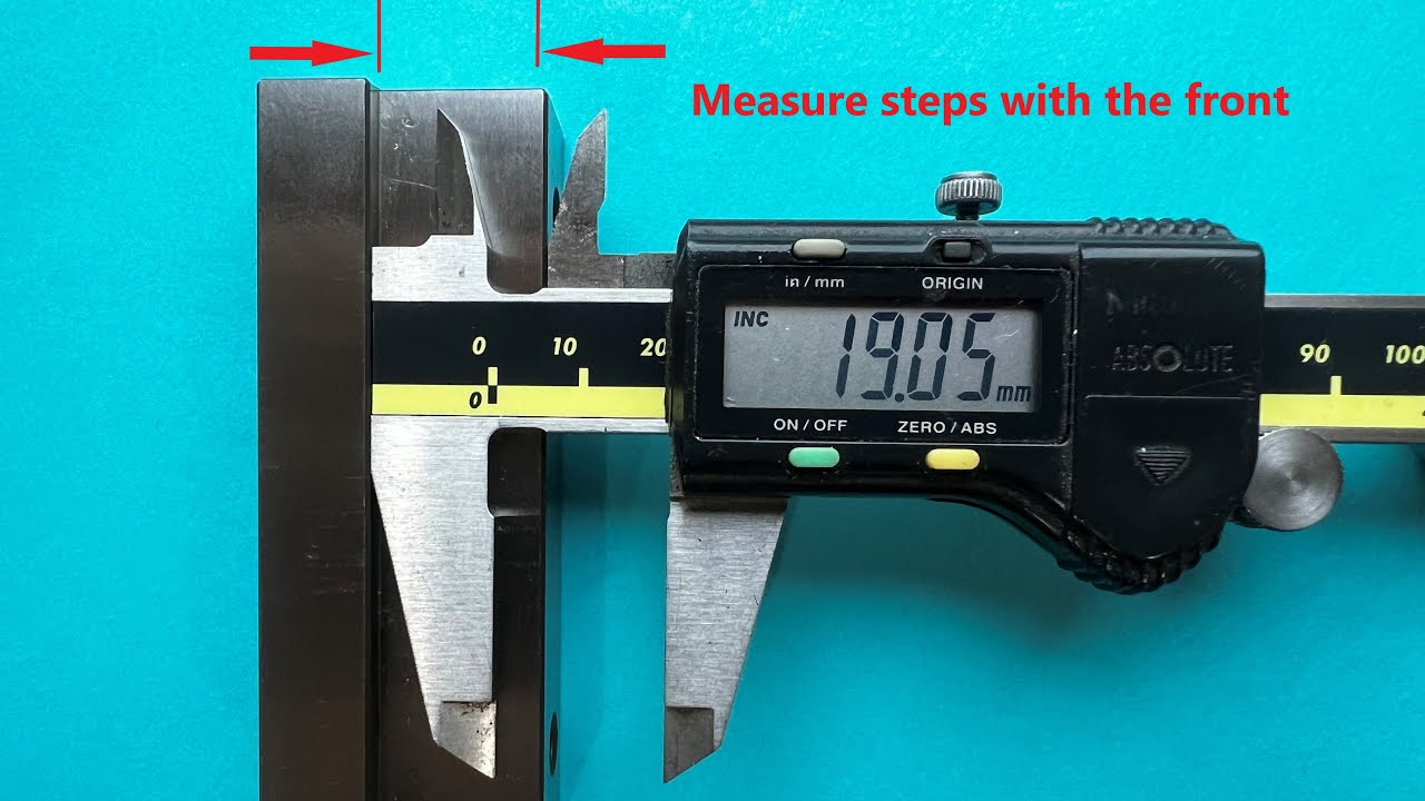

Although I will say I use Chinese calipers and they must have got them down to a science because they’re great.
One day I’ll pick up some mitutoyo’s
This was a good video too with some neat tricks.
