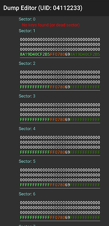

I tried to clone a card with MTC and i get an error reading sector 1 & 2 on the UG4

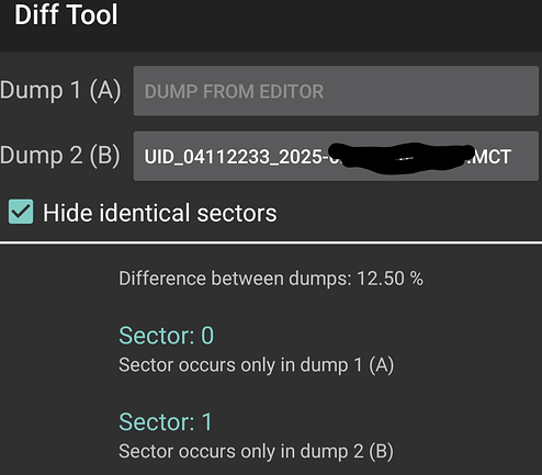

Dump 1 is the original card, dump 2 is the UG4 after the original dump was cloned to it. I don’t get why we have a discrepancy in the available sectors?
For some reason MCT is not able to get in sector 1 on the UG4 :face_with_diagonal_mouth:

the stock proxmark doesnt play well with the ug4. I’d definitely recommend getting one of hammy’s proxmark enhancers

I tried my ultimate card, and I have similar issue on another block, the proxmark’s Lua script error when trying to wipe, and some sectors are locked.
I tried the UG4 prior install with MTC and it went great, the card always gave me issues …
Ps: the crappy hotel readers gets a read with the MTC dump on the UG4 (and a @Hamspiced tank circuit :grin:) but it deny access, I’m suspecting due to the sector 1 not being able to be read by MTC

this looks like you’ve loaded a 7byte UID dump on a 4byte UID configuration, reconfigure for 7byte and try again
