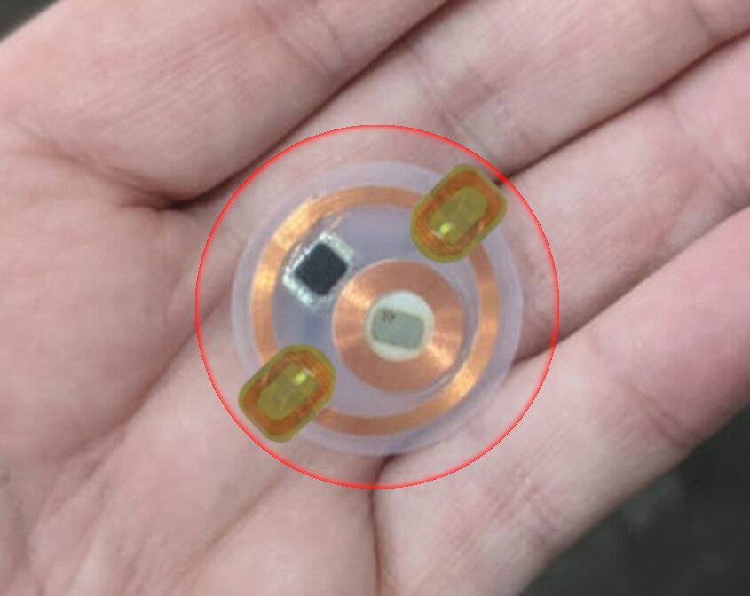

Okay, let’s start being annoying rightaway ![]()
Is this an option?
The red circle is the footprint of a flexNExT.
I’m thinking for us flexNExT wearers reusing our larger pockets for the smaller flexMN: placing the blinkies such that the antenna part of them act as anti-rotation tab, and the LEDs are more or less over or very close to the magic NTAG’s coil so they’re better protected against delamination or whatever is happening to Azflyer’s LEDs.
Or would it kill the field for the magic NTAG if they were placed that way?
Or more realistically:
Also, unrelated: are there LF nails?
I have no idea how you photoshop a picture so fast. This is mind-boggling ![]()
Haha omg… maybe? Jeeze let me try some things… though I’d probably put the LEDs facing the outer direction
Wouldn’t that leave em hanging in the breeze unprotected?
