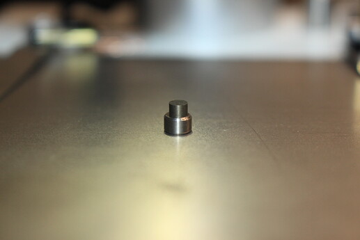

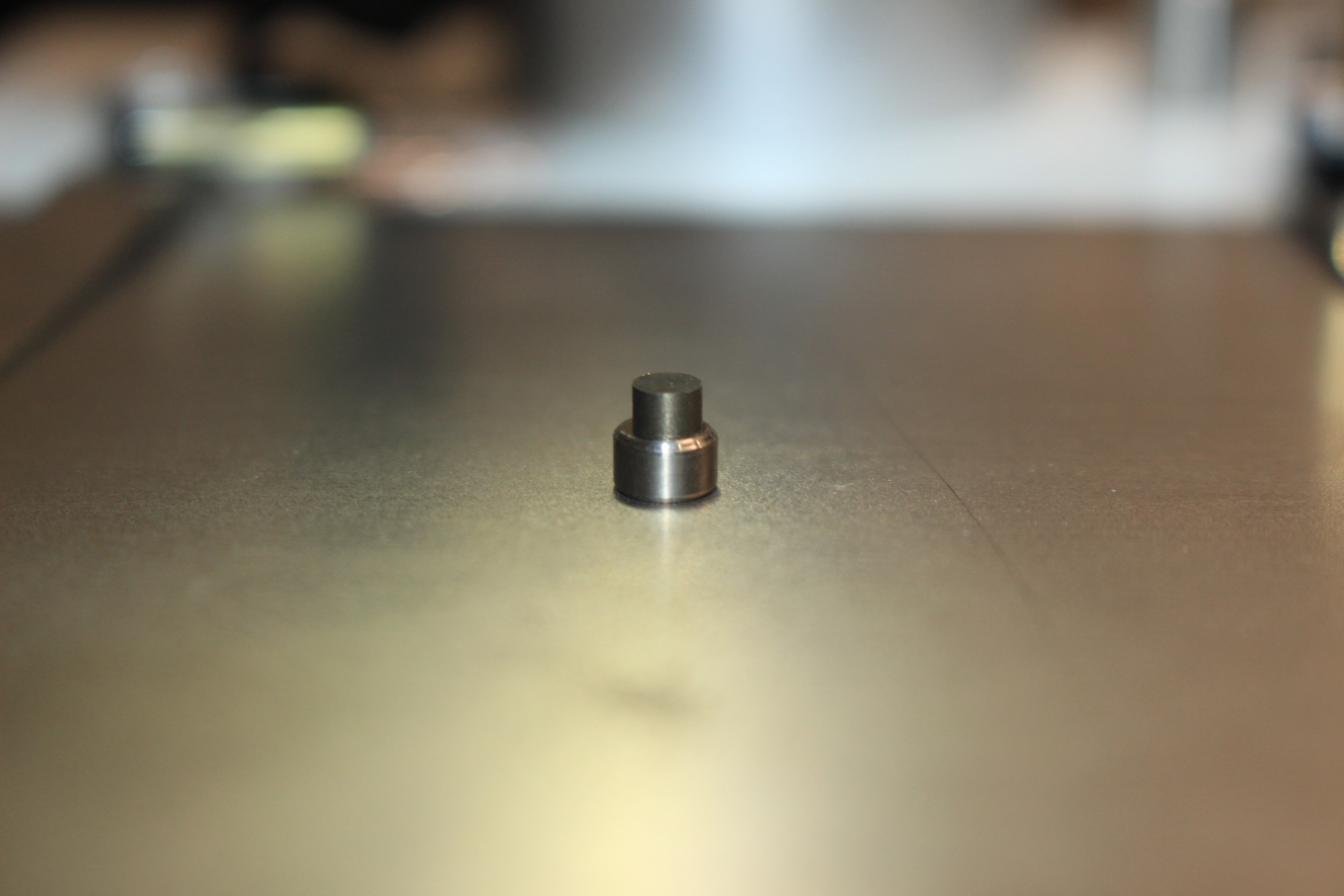

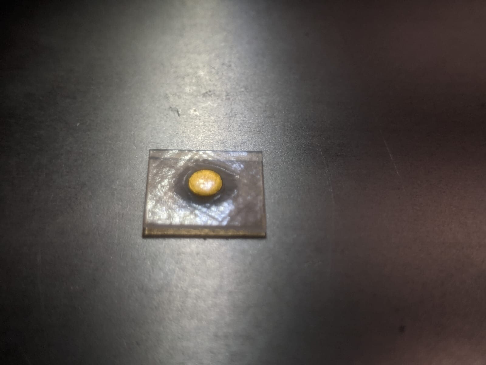

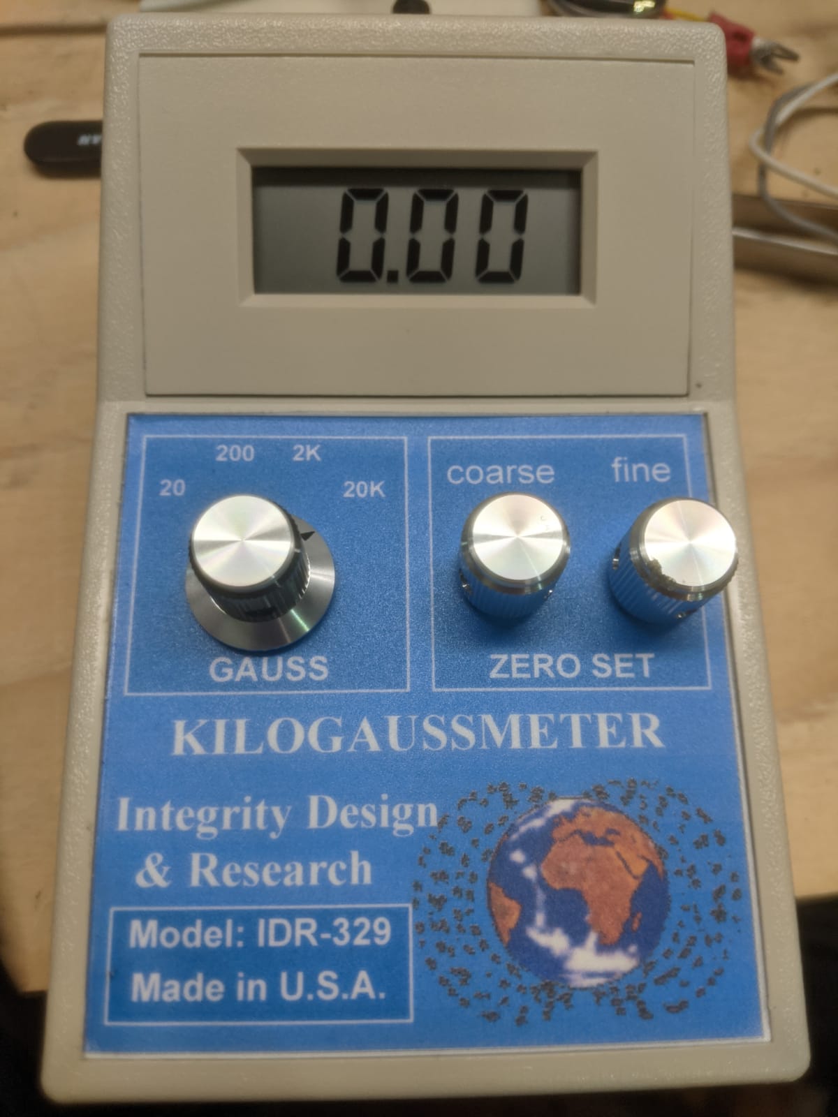

Ok I was able to dig out my Gauss meter.
Because there is no max hold option with this thing, and the sensor itself is super picky about placement, I had to stare at it while I worked the sensor over the surface of the magnet (hence no pictures of the actual values).

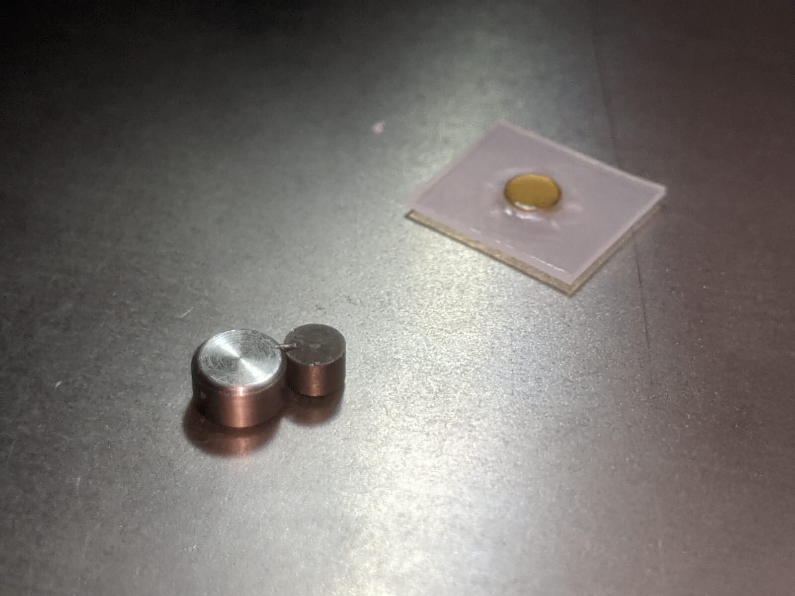

Here is the 2mm thick, 3mm diameter N52 magnetic core resting on top of the Titan.
Here are the numbers
With the meter set to the 20k range and an tight average across 5 test units, we are seeing the following numbers.
- 4.40 (4400Gs) is the max observed peak of the raw magnet core used inside the Titan
- 2.85 (2850Gs) is the max observed peak at the surface of the Titan
You can see how the Gauss field strength of the magnet core weakens exponentially with distance. If you’ve ever played with magnets at all you should be very familiar with this phenomenon. That “snapping” sensation when you stick a magnet to something ferrous or to another magnet is the field gaining strength on an exponential curve as the magnet closes the last fractions of a millimeter. Even the difference of the last 0.4mm nearly doubles the field strength.
This is why we worked so hard on the m31 magnet… the designed coating was only 0.013mm thick! If it had worked, it would ensure the maximum sensitivity due to lowest possible inertia and the maximum Gauss strength at the surface of the skin for any given installation. Alas, it was not meant to be… so instead we have the Titan… a magnet implant that is designed to last forever.
Core integrity
To ensure core integrity, I performed another Gauss test.
- 2.90 (2900Gs) is the max observed peak with 0.38mm material between the surface of the magnet core and the sensor. This test uses an untreated core and 0.38mm thick plastic material.
The plastic spacer material is a stand-in for the titanium shielding around the magnetic core of the Titan. The fact the Gauss readings of this core + spacer are on par with the Titan validates that the magnetic core inside the Titan has not be affected by the heat of welding in any permanent way.
More test data to be posted soon… just digging out my force meter…

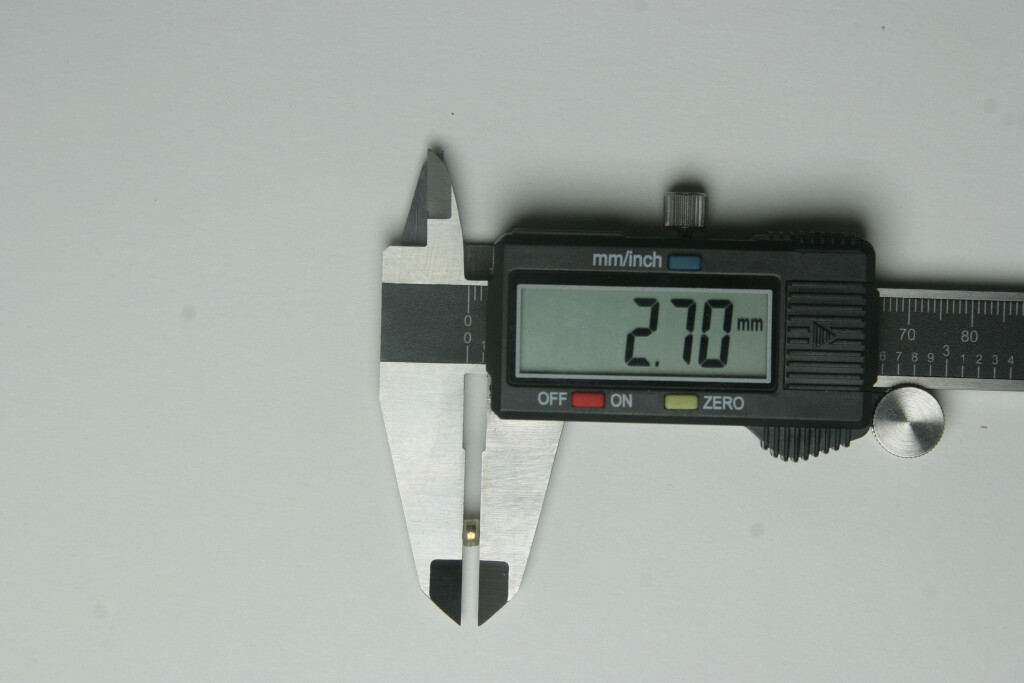

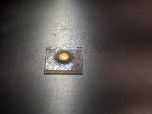

I am actually encouraged greatly by this because this m31 (3mm x 1mm) …
is covered with only 0.2mm of material registered only 0.835 (835Gs).

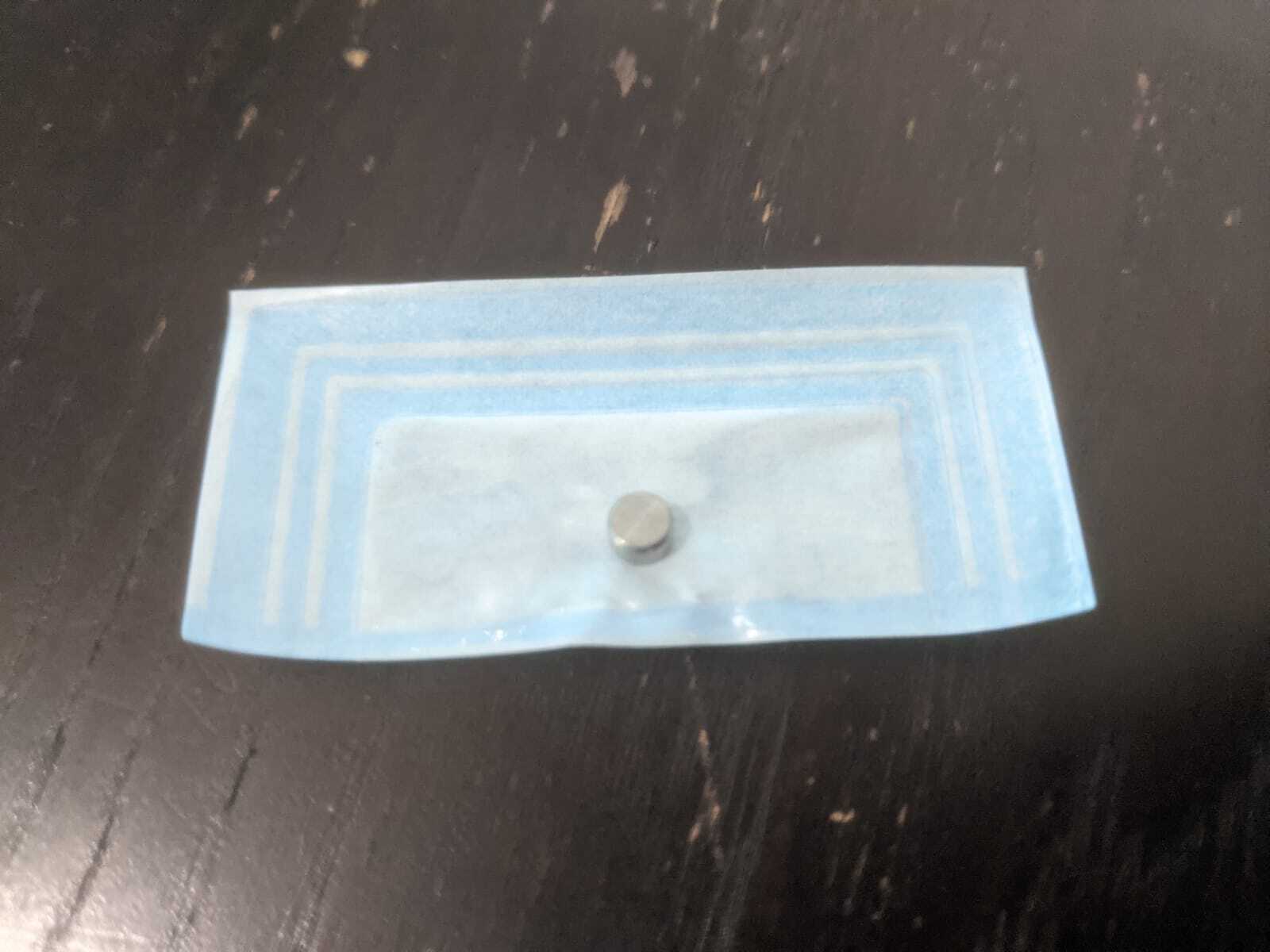

This looks very interesting… has anyone the values of the two different Haworth-magnets, by chance?
I was able to test a Haworth magnet at one point during m31 design. Here are my notes from that time…
Haworth (w/o silicone 3.2mm x 1.65mm, with silicone 4.1mm x 2.7mm)
1850Gs silicone surface
3231Gs magnet surface

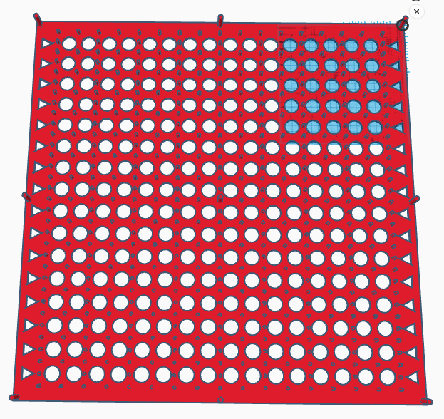

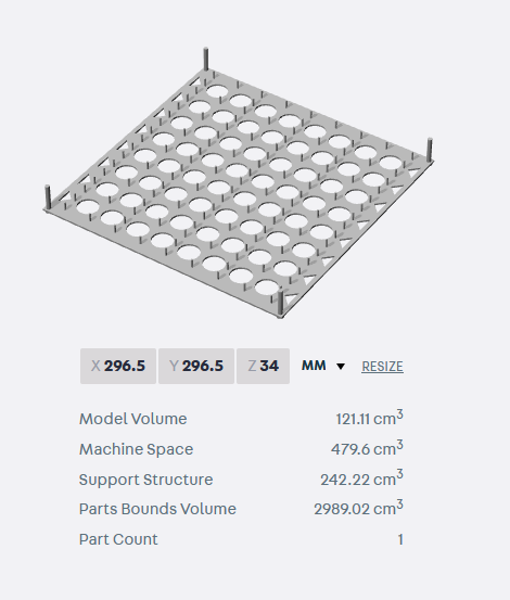

I’m now working on the pouching and custom processing trays required to run magnets through a commercial sterilization process.

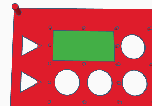

haha well I think my design was too large… commercial 3D printers only offered a single material and the total cost was $2000 hah no way. I broke the tray up into 4 quadrants … but it’s still quite large… still quite expensive to get printed, but more importantly the print schedule puts receipt of the trays well into January. That’s not good.
Anyone here able to print these trays in ABS? The smaller tray has these dimensions;
I am totally willing to pay for prints… the issue is speed… speed is of the essence here.
The STL is as follows;
titan h2o2 processing tray 2.stl (1.4 MB)
