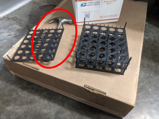

This is an official shipping update…
Titans will not ship until after Christmas, but everything is coming together to be able to ship shortly after. Chamber testing is still in process and there has been no indication of metal fatigue or field strength loss.
Some trays have arrived, with a bulk of them in transit to me now.
Once they all arrive the pouches will be loaded and trays will be stacked and I’ll ship them all off to the sterilization processor!
Great update Amal, but I just want to watch you open a cardboard box with a hammer…
Or maybe a hacksaw
hack box
I sometimes put easter eggs into photos and videos to see who catches them. This was unintentional, but I do enjoy the fact at least one person will be going back to have a second look at my recent posts :wink:
sneaky amal
As long as my envelope wasn’t opened with a hammer :wink:
giphy (2)
…you DID get it tho right?
laughs at mc hammer dance nervously
