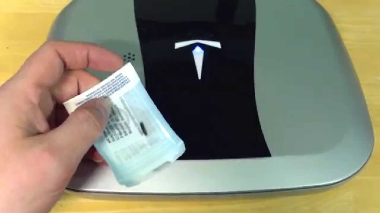

The xSLX is an ICODE SLIX2 chip operating at 13.56MHz and complies with the NFC Type 5 specification.
The xSLX chip is useful as an ISO15693 or “vicinity” transponder, and is compatible with certain commercial access control systems using ISO15693, as well as certain products which are compatible with ISO15693 transponders such as the padlock and door latch at thequicklock.com, and the GunBox series of RFID pistol cases.

Bundle deal for xSLX and the gun box safe shown in the video :wink:
