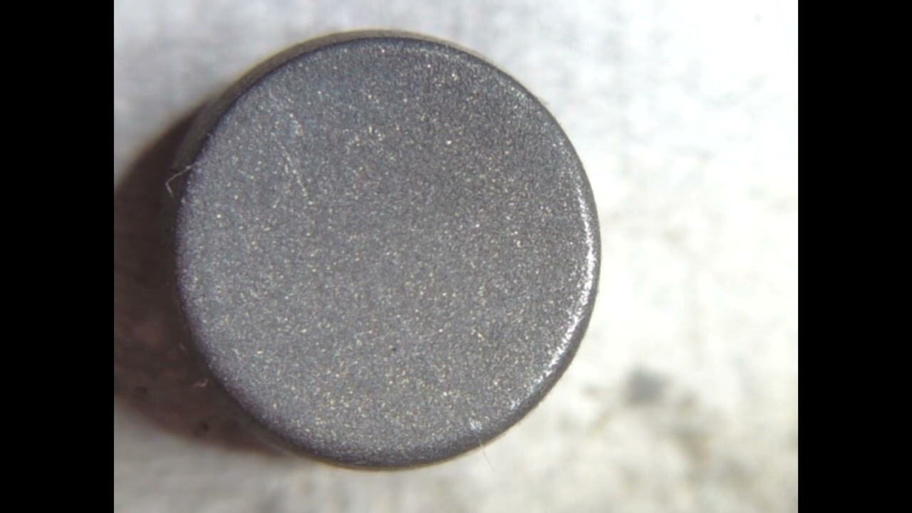

Ok I finally got my microscope set up on my desk so I can do this properly.
TL;DR
  • The surface is treated and material of some kind comes off when gently scraped.
  • This could be excess material used in treating the surface or oxidized titanium from the surface which has been blasted so badly it’s loose and easily comes off, or a mix of both.
  • The effect of the surface treatment itself should encourage cell adhesion, which could improve sensing capabilities while making removal more difficult.
  • A process is being explored to remove loose elements of material without destroying the efficacy of the surface treatment.
The longer version
What follows is quite rambling.. I cut a lot of it out just for sanity’s sake.. but what I did leave in is still quite a “stream of consciousness” thoughts-in-the-moment word salad. I will clarify some of the things I’m blabbing on about in text below the video.
  • Even though I make definitive statements in the video, I can really only say that the dental magnet in question appears to have a partially treated surface wherein some material is left adhered to the surface of the titanium, which appears to come off when gently scraped.
  • What might actually be happening is titanium dioxide which has been oxidized from the surface treatment itself is easily sloughing off.
  • The treated surface may actually encourage cell adhesion to the magnet and create a better bond with soft tissue.
  • Risks and health effects of any material that may come off the magnet post-installation are unknown at this time.
  • Effort should be made to remove the loose material without destroying the surface treatment, allowing for some level of soft tissue adherence.
More work is being done now to test various buffing / polishing treatments which will address my concerns while not entirely removing the surface treatment.

Well, to be honest I don’t think this is stuff just laying on the surface. I think it is;
  1. bits of abrasive material which is partially embedded into the titanium
  2. bits of titanium “flakes” sticking out of the edges of blasted out craters
Thermal shock might dislodge embedded bits of blasting material, but I don’t think it will do much for any “wispy” flakes of titanium that are barely hanging on for dear life.
My goal is to remove the flaky bits at the surface and leave the deeper pits alone to allow some cell adhesion.

Well I’m not wanting to cut it in half or anything :slight_smile: Just some gentle treatment with some polishing compound perhaps.
I was thinking more like take an aluminum plate, mill a close tolerance diamter hole in it that matches the magnet with a depth that leaves the crusted bit exposed. Route vaccum into the bottom of the hole, insert magnet, turn on vaccum. Bonus points if the bottom of the hole is steel (adjustable height?)
Now take one of These, and run it around the diameter so that it just kisses, thereby removing any thing sticking up but leaving the pits untouched. A few passes over the top, and then swap it out and run again.
The aim being minimal effort on your part (after setup) and a consistent repeatable process.
Ah yeah gotcha… anyone got a desktop cnc? I had similar thoughts about setting up a jig and instead of using a CNC just using a Dremel buffing tool to test various compounds… I do like the idea of repeatability though. There are some other concepts I’m considering as well that would be fairly easy to get repeatable results with.
