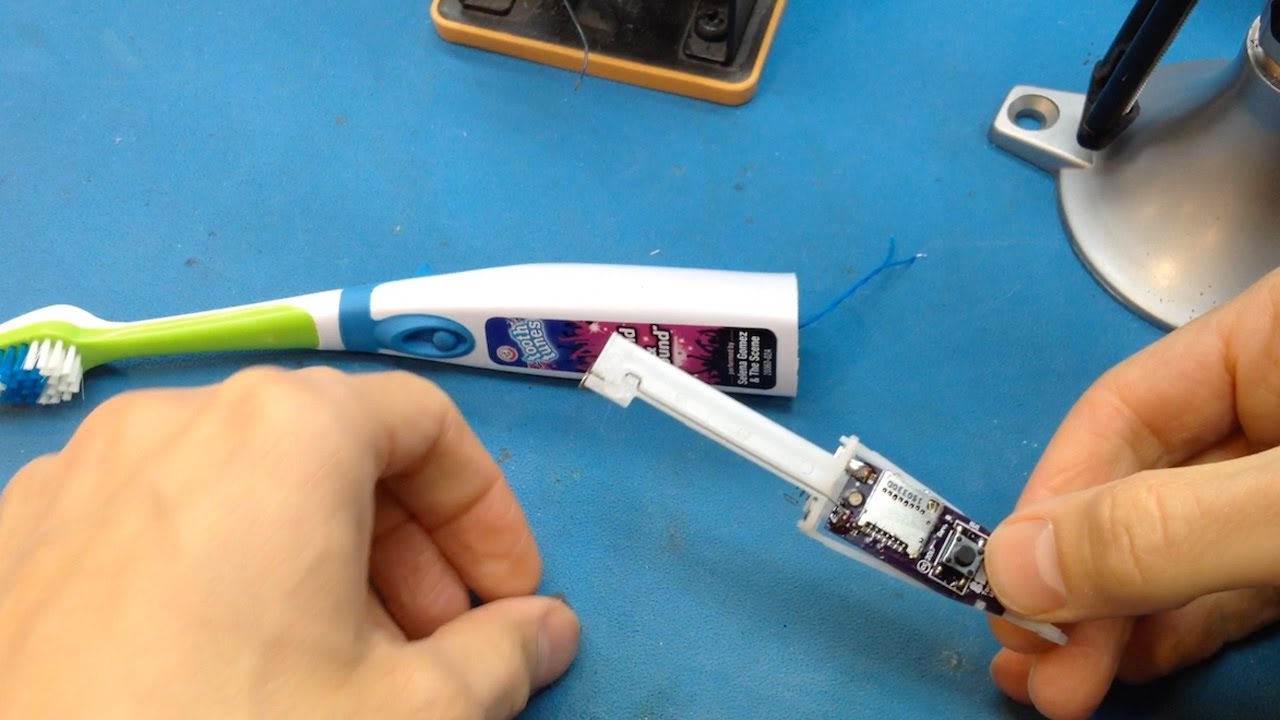

Let me test more if it vibrates in your fingers it may just clink around on your teeth. There was an old kids toothbrush that played a song…hmm how did that work.
