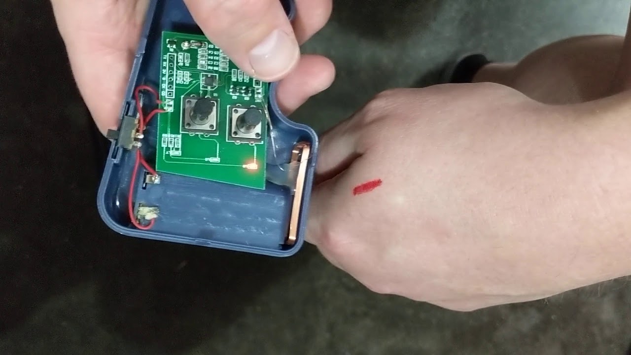

Did you open it up to access the actual antenna?
Took it apart and it made a dramatic difference in the field detector. But no magnetics could find it. It must be deep, because they didn’t even feel it at all. What are implications of it being in the muscle?
Yeah, sounds like it is quite deep, maybe in the muscle, Hopefully not…

I dont have mine with me, but pretty sure it comes apart at the seam in two pieces, the antenna, is a small board antenna, probably stuck to the front face
That is what you want to access and press on your implant

Just some short notes… if the ndef record gets corrupted during writing to the NFC chip in the NExT, iPhones and many Android phones will just give up. That’s because when you write data to an existing record it seems to want to modify it instead of overwriting the entire thing… probably to help with keeping block write counts down… but anyway a broken ndef message or record envelope will result in borky mcborkface… you may have to use a “format” or “erase” function first… but that might also fail because most apps don’t properly handle the lock bit disabling or auth0 password protection we set up and ugh… we just need to release a better DT app I guess…
Also with the blue cloner, this is how a write should be attempted on an implant;

Good video Amal. It would almost be worth ungluing the coil, cutting two notches into the edge of the lower clamshell, and gluing the coil back on flipped 90 degrees, with one long edge sticking out of the casing through the notches, so it’s usable as you describe without having to open it up.
Yes some have done this. It’s a good idea.
