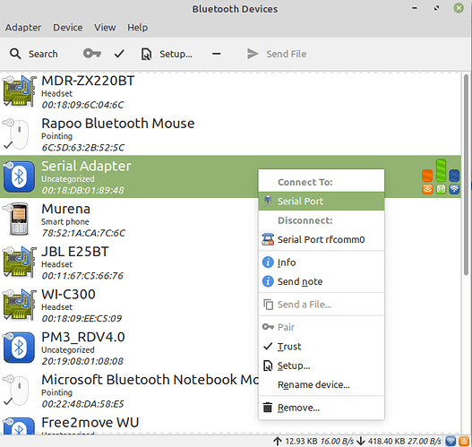

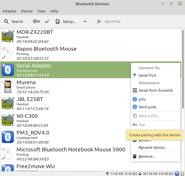

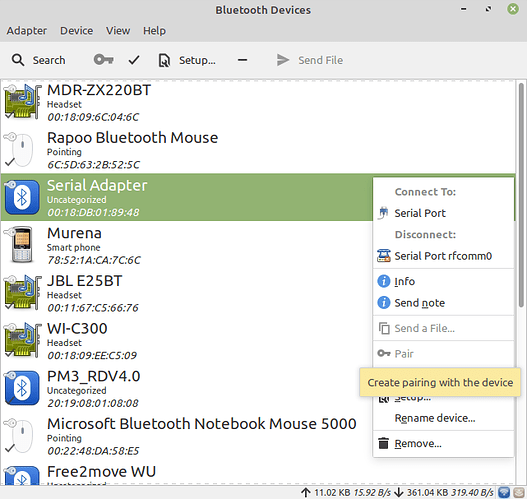

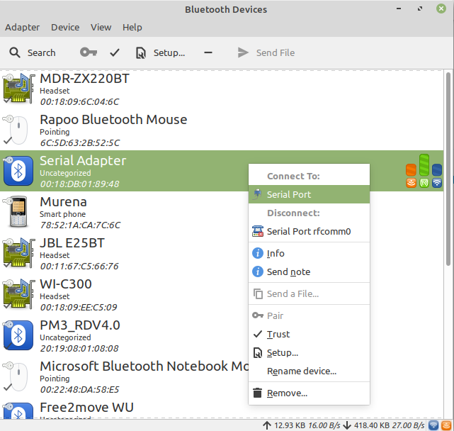

To configure it in Linux, pair it with Blueman:
Then connect it as a serial port:
