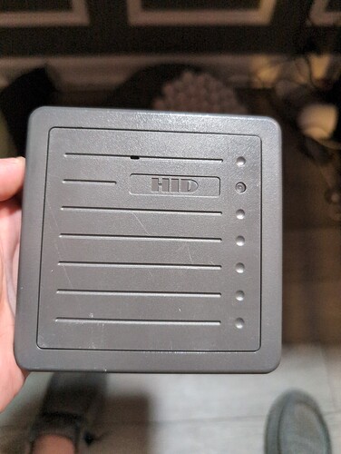

The outside reader is likely an HID Proxpro.
Looks like this?

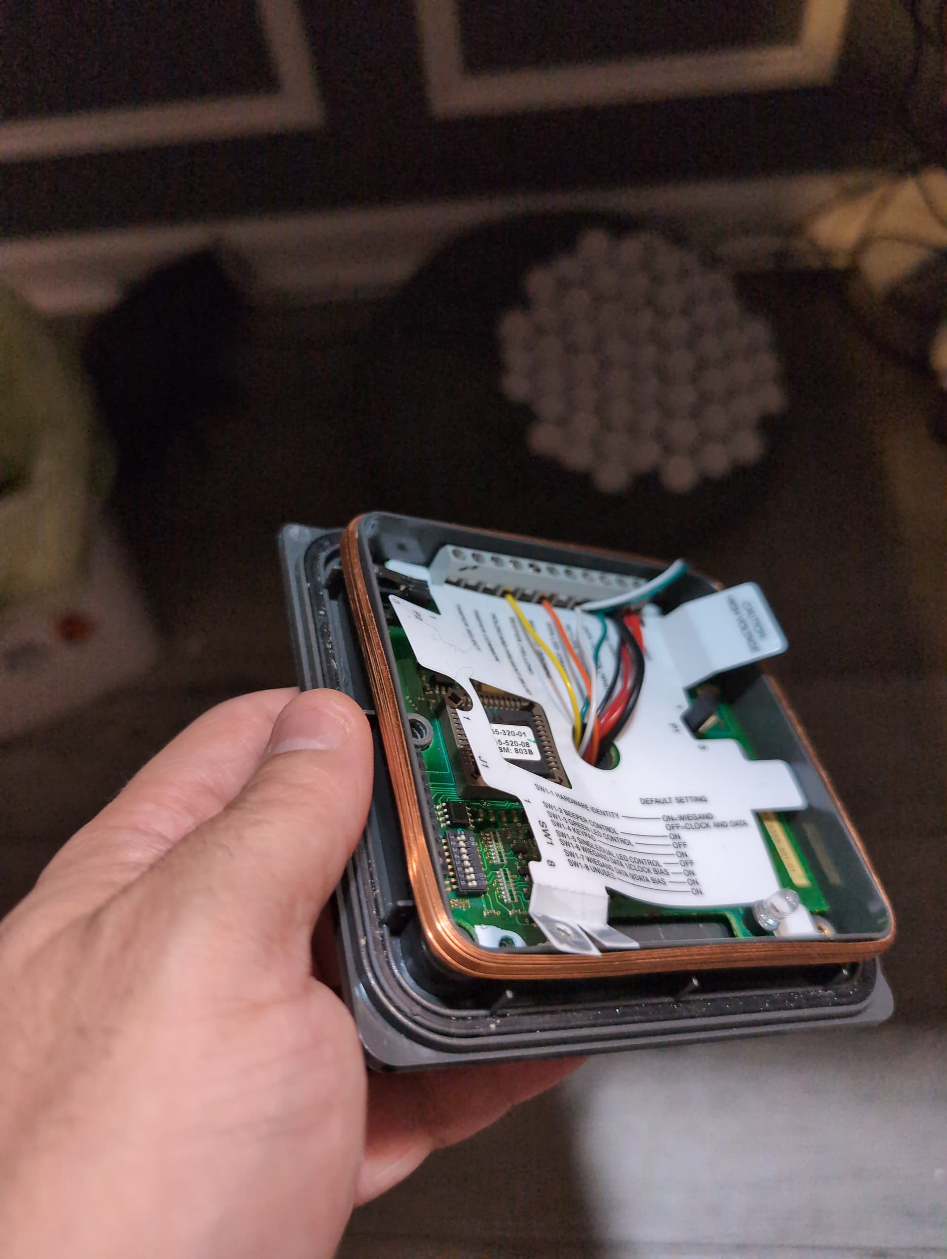

These are nice units. High power. Look at that coil
Interior units are likely something smaller with a different field area or go into a lower power mode.
Try finding different orientations to present. Perpendicular to the coil is best.
The one inside reader that can see me looks just like that. The outside readers are marked HID but are about a third of the size of the one in your picture. Those also work well.
The ones that aren’t seeing me (but work great with cloned cards), look JUST LIKE the HID in the photo, but they are marked CardKey instead of HID.
I’m really hoping that as I heal, the read range gets better and all the work readers will see me. I’ll bring my keychain next time I’m at this facility next week. I’ll be going to the other facility tomorrow and see what results I get there. I want them all to work, tho!
I am willing to bet they are just lower power. like 5-12v. These HID readers operate on 12-24v and are just beasts of machines. I have a Maxiprox and a R90 and they are GIANORMOUS. the coil on it is just incredible. But with it comes extreme costs, i think the Maxiprox is like 1,000$ new. Those Cardkey readers are probably around 10$, lower power, smaller antenna.
