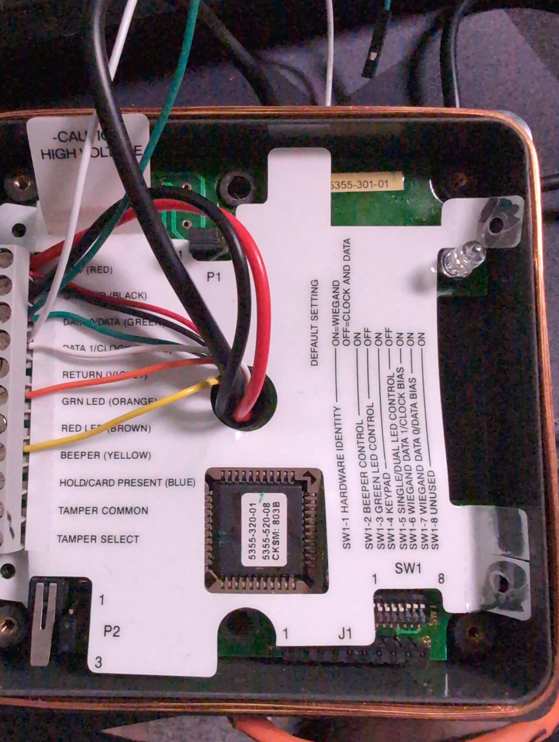

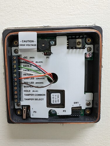

There are a few doors at this facility that used to be secure, but are no longer, but the readers are still active. There are just no latches on the actual doors. I took the cover off of one of the CardKey readers, and this is what I found.
Hey that’s an HID Proxpro.
So that one should work fine with your implant. Switch p1 should be the power saver switch. I’ll have to refer to the documentation
For reference I have the same one on my desk. So it may be a clone. Let me dig for the documentation
Interesting! The ones with HID labels on them work fine. I would have to ask permission to remove the cover of the one CardKey that sees me, and I might do that next week when I’m back at this facility.
Though, if you have documentation, I can probably play with the one that doesn’t control a door lock to see if I can get better results too.
Thank you for the help!
Refer Below:
I was wrong Jumper P1 should be flipped if installed on a metal wall or junction box. (See 2.9)
Tamper is correct (2.6)
So at this point i can only assume that the issue is because it is being fed 12v instead of 24v which it is capable of. Thats my quick and dirty analysis of this atm. But judging by what i see here it should have zero issues reading your NeXt.
In its current state though it shouldnt read anything with the cover off. If you wanted it to function with cover off youd have to move the tamper jumper from 2-3 to 1-2
Also judging by the fact that true Proxpros work good, and these ones labeled card key doesn’t it may be that the clones are just bad clones? I’m just not sure at this point

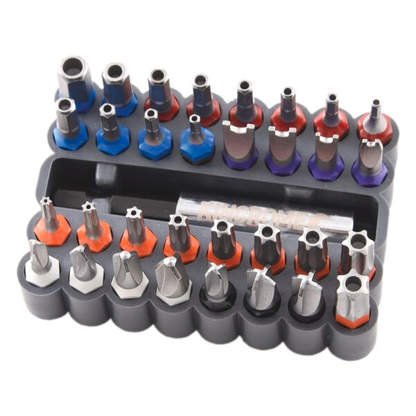

Do you have a security bit set you could take with you?
something like this
You may find it uses a security screw, or a torx, hex or even just a posi or phillips.
But, I would hate for you to show up, get permission, and then not have the tools to access it
if it is the same setup as the HID Proxpros, the front plate just pops off with some leverage, and then there is 4 standard phillips screws inside that hold the face cover to the back plate… the front plate can easily pop up with just a knife along the edge. it is friction fit within the screw hole cavities.
@Pilgrimsmaster
Yes! It’s like @Hamspiced said. On the inactive one that I already looked at, the front pops off, and there are just flathead screws securing the cover in place.
