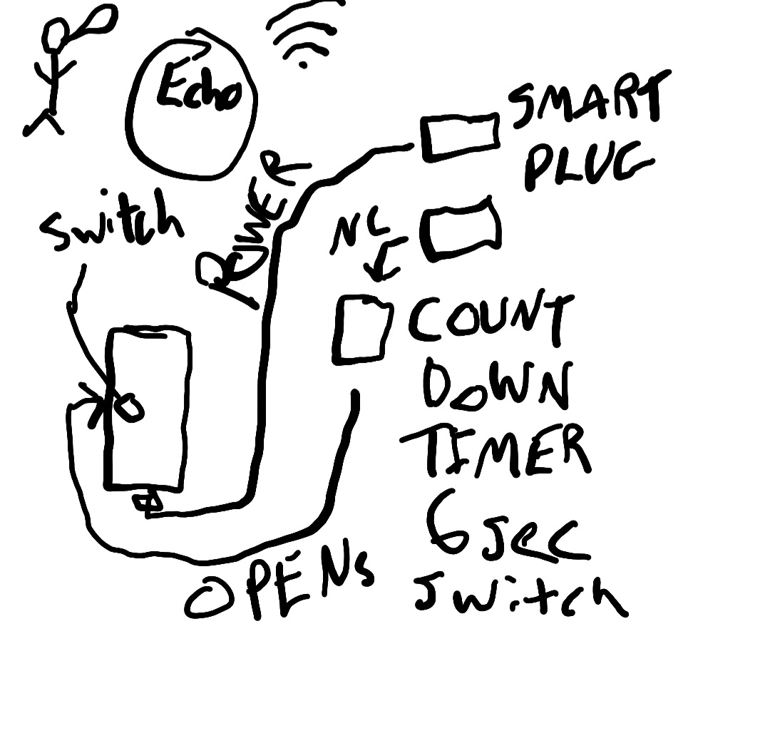

Here is a terrible sketch of a think I have set up and working. Description will be below to walk through it, clearly it isn’t drawn by Vermier but I thought a picture would help.
So I have a thing… I use voice command now to activate an Alexa routine that activates two smart plugs. One plug activates the device. One plug turns on a count down module that counts down and then opens a circuit inside the device <I need the device to boot for a couple seconds, then break the circuit to deactivate a sleep timer on the device>.

I was trying to not get into specifics until it was done… but it’s a lightsaber project using GE sabers. This project will be a Darth Maul saber (which further complicates things as a bunch of stuff needs to occur twice, and some stuff once). Step one is a conversion from DC to AC, step two is tricking the device into thinking that the blades were removed to bypass the 10 minute auto off countdown timer and disable the lightsaber sounds. It will then act as a nice little lamp. My idea for this one is to use my off hand to discretely trigger the RFID reader while gesturing with my dominant hand for misdirection to “use the force” to activate it.
Existing lamp uses two smart switches and voice commands via Alexa to turn on and off the device.
