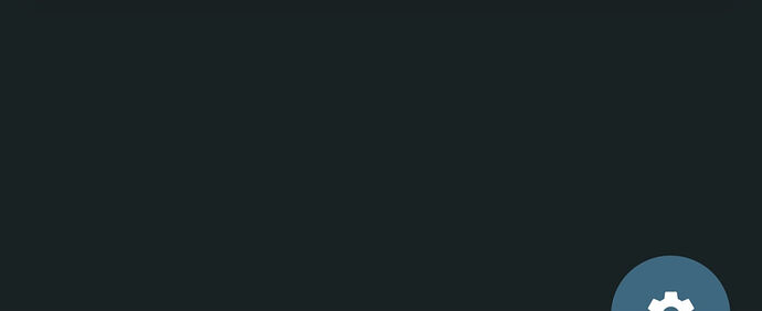

One minor UI thing, on my Galaxy S22+ the settings gear at the bottom half displays under the phones soft nav buttons. I tried to take a screenshot but it doesn’t capture the nav buttons just shows half the icon.

@Dondula Noted. Thanks for pointing that out by the way! I haven’t seen that on any of my test devices but I can emulate an S22+ and fix it.
