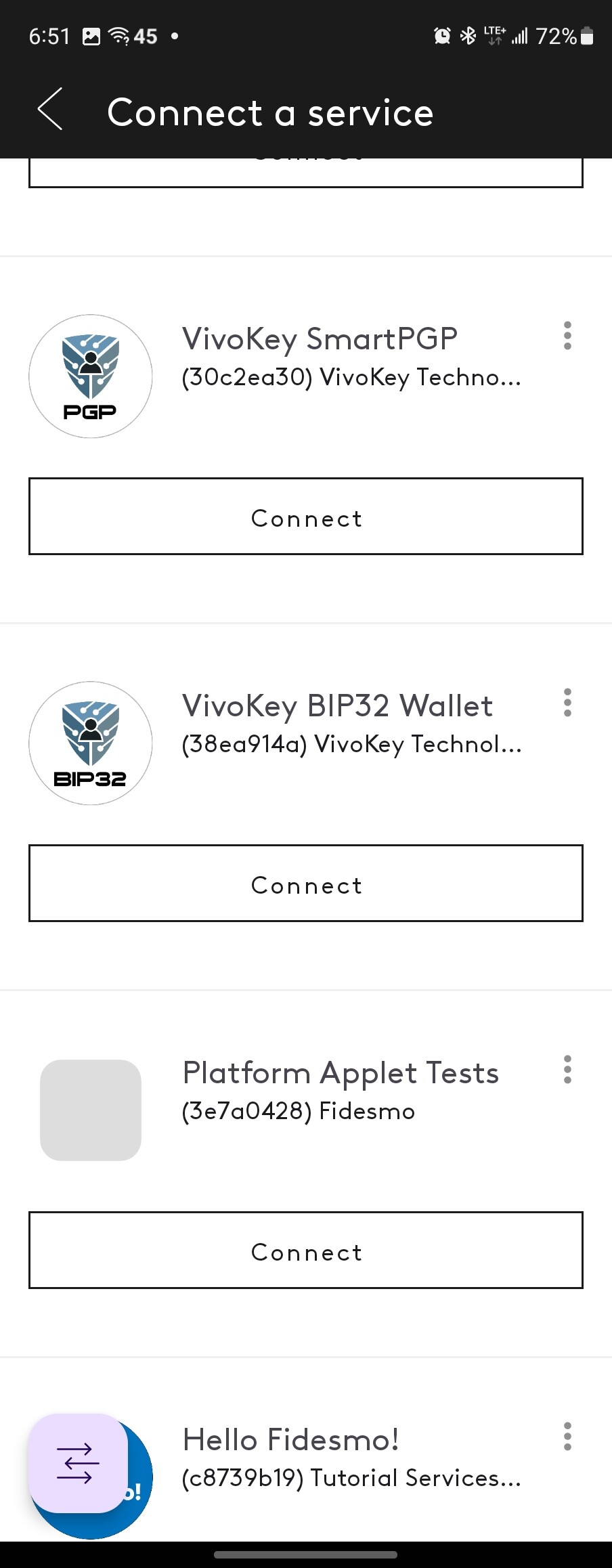

interesting… can you post a screenshot of your home screen with all the apps listed? you can block out your ID if you want.

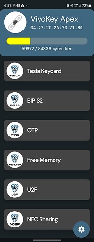

SynchronizeP71UseCase: java.lang.IllegalStateException: Call connect() first!
App says “Improper coupling, please rescan”.
I’ve got the Flex beta pretty close to the Apex, but Fidesmo is working flawlessly.
Fidesmo reports BIP32, NFC Share, OTP, FIDO.
EDIT for posterity: Seems my “NFC Share” 16Kb old old NDEF applet broke it. After deleting that app it works fine, and I’m assuming I can reinstall the new version and it will still work fine.

I get this error with my apex even after removing the ndef and free memory applet
Edit: looks like removing the tesla key applet let me in
Thanks for the report, Ill have a look - maybe its the same bug as before.

I have fixed and updated the Tesla applet on Fidesmo. It does now no longer disrupt the App when listing applets.
You have to re-install the Tesla applet using Fidesmo. This will destroy your keys and enrollments.
