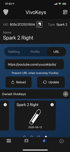

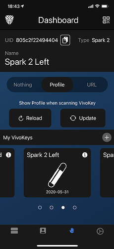

Looks kinda busy but I kinda like it like that. What do you guys think?
You can copy the chip UID and also the Implant ID. Change URL or name of the implant.
I’m working now on “Adding a new VivoKey” button and screen. Once is finished I’ll make another video.
Yes it is busy, but it is still tidy, logical and full-featured for a single page :+1:

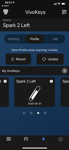

I did have a couple of thoughts that may slightly improve usability/reduce feeling of busyness on that screen.
  • Helper text ‘Present URL when scanning VivoKey’ could be moved to directly under the mode selector before the URL field to make it clearer what changes it.
  • Reload and Update seem a bit confusing. Perhaps ‘Cancel’ and ‘Save’? Could have the Save button un-grey-out itself when a change is made to give a visual cue that there are unsaved changes
  • Maybe I’m being pedantic here, but instead of ‘Owned VivoKeys’ I’d go with something more like ‘My VivoKeys’ - feels more in line with the iOS user centric thing
  • Maybe UID and type could be moved to the ‘i’ panel on the implant selector? I’m not sure how often people would need to copy it, and for identification there is already the nickname
Agreed
That or Re-Read and Write
Adding “My” always is good for consumer fronting applications
Another agree
Now that’s some nice feedback. Let me see if I get it.
About “Present URL when scanning VivoKey”
I had it over the URL. but then it separates too much. The URL thing shows up ONLY when pressing URL. Otherwise the “Present URL when scanning VivoKey” changes to another text and is right under the selector. (not trying to defend my alignment, just saying I’ve tried that already and looks kinda funky)
About Reload and Update, yeah, I was thinking, reload shouldn’t even exist and Update should be just “Save” and it should just show up when you actually made changes. But the way that it works now, is that you can make a bunch of changes to any of your keys and decide to cancel them all.
Perhaps I should make it more of “Click to edit” and “Done” and just show a list of VivoKeys.
But then again, most of the people just has one, so it seem redundant to make people go to this tab and then click on the only key they have to edit it. Thats why I went for the carrousel thing on the bottom.
IDK what do you guys think?
My VivoKeys actually does sound much better, I changed it already thank you.
You know the “i” is a popup with the ID of the chip.
Thing is, there are two IDs for each chip. One is the actual UID of the actual chip that any scanner can read. Many devices just use this to identify a chip. Just like the RFID.
The other is the Implant ID that comes from the VivoKey server and is much much longer.
I thought people who is developing their own contraptions (arduino or raspberry pi or whatever) would like to have a quick way to access the normal UID. But I get your point, they might as well just get it from the reader inside their projects.
I’ll move that data to the “i” place too.
Little change lots of code drama. :joy:
I’ll fix it.

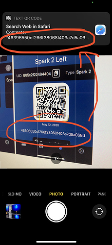

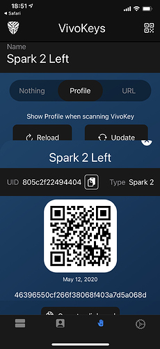

Why do you need a board code in the app I am a little bit confuse can you explain a little bit.
I think what you referring to is the QR Code.
Is an easy way to let another device read the digits instead of copying it one by one.
So if I want to copy 9816238941623896129369123691236 is easier with a QR code because any smartphone can read the data. You can try to read this QR code with your phone right now and it will show you the long number on the bottom.
This is the ID of the chip. Sometimes people might need it to put their ID on a program or device to tell it “ONLY WORK WITH THIS ID”
I was actually thinking it would be better with the normal UID of the chip.
Actually the design has changed a little bit since I am still working on how to show the data here.
