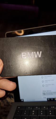

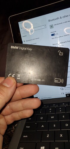

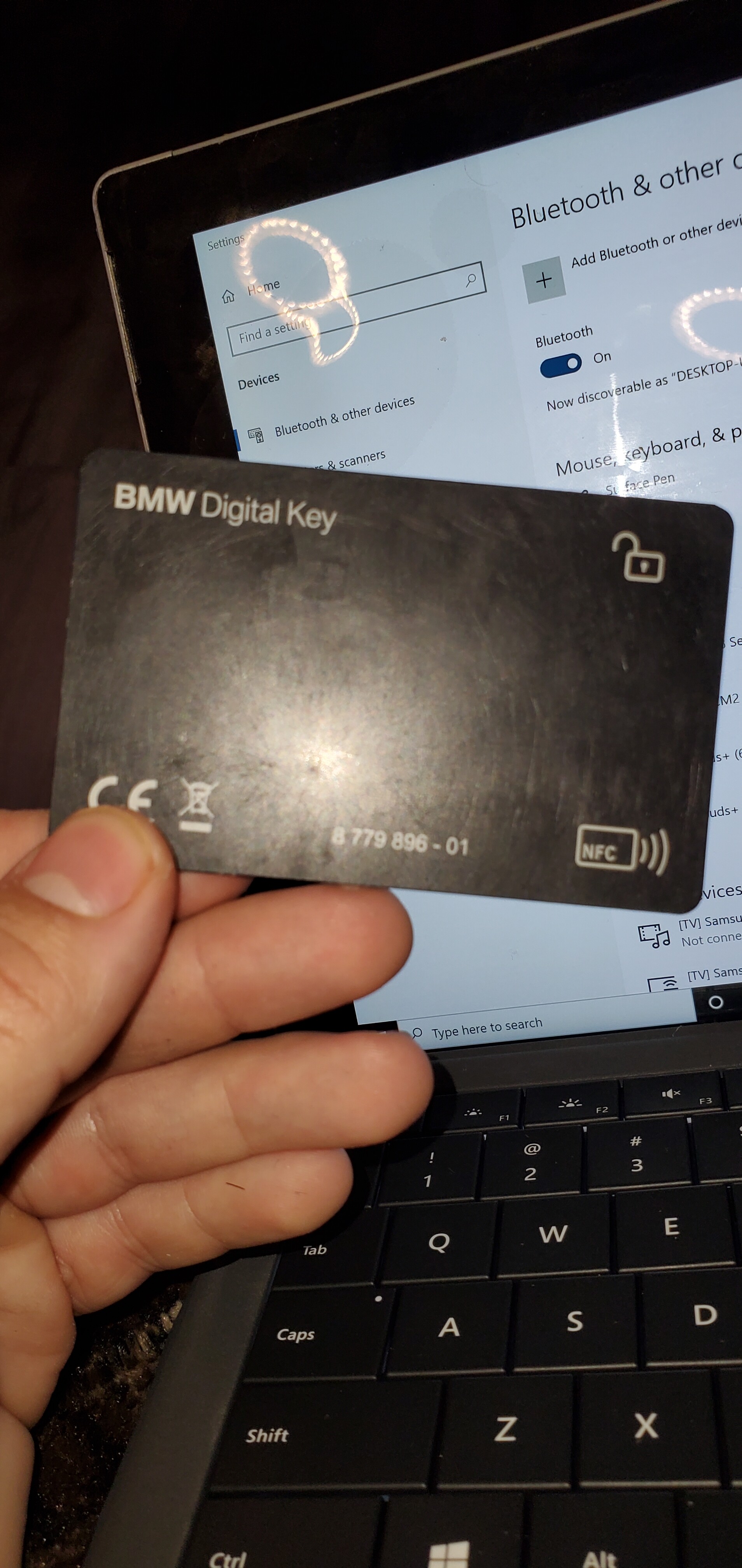

Also is this an actual key or a key card? Photo of the key?
So the app It isn’t letting me save the XML file and it is a card

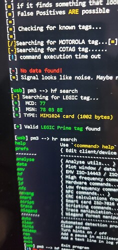

Interesting… do you have a proxmark3?
I just got it in the mail but have no idea how to use it yet so watching videos on it as we speak
Did you buy from Dangerous Things with the Iceman firmware preloaded?
What platform are you using? Linux, Windows, Apple?
Just a suggestion
This is a good guide to follow…
You shouldn’t have any issues if you follow it exactly, and if you get stuck, it will probably be easier for us to help you through it
Yes I did and thanks for the info!

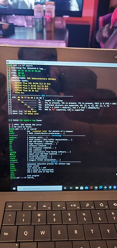

I’m thinking it might be fun to sniff the traffic between the car and card with the proxmark3 just to see how it works… then maybe it might be possible to put on a chip implant. Worst case we could prob convert it to an implant.
Yeah I’m working on setting the proxmark right now that I’m back home. Will upload once I get that info for you
The (in SL2) portion implies AES keys according to a document I found. That would make it more likely to be a Conversion candidate afaik
