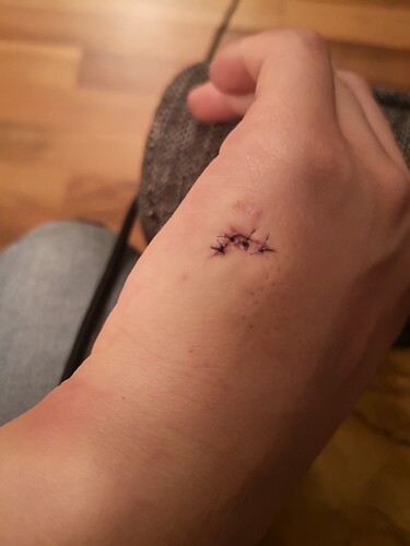

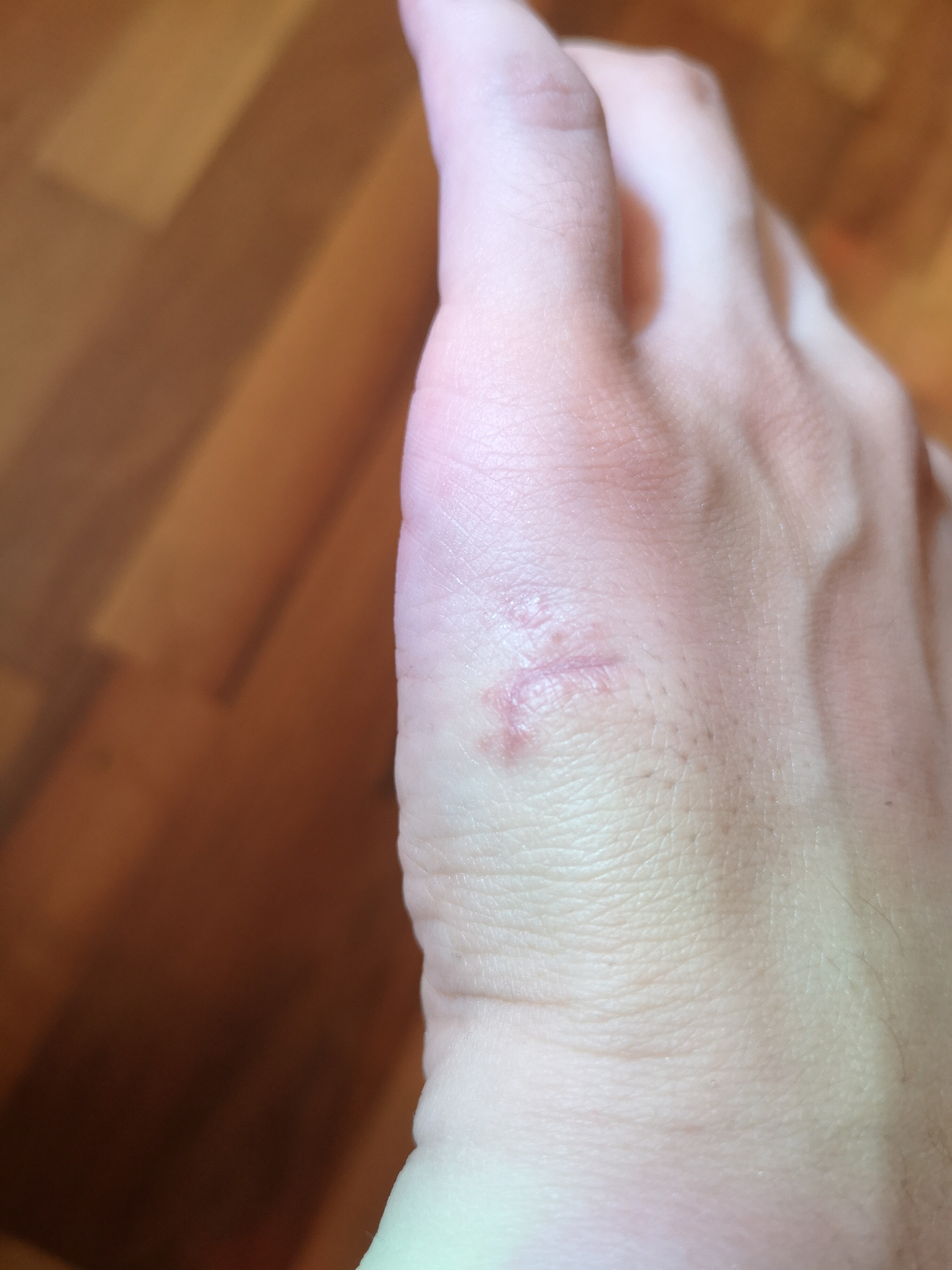

I got mines installed here with lido using the dermal lifter technique, and it was closed with sutures. My scar is a little larger than normal, as I was replacing an x series, but typically, it’ll leave a small line once healed.

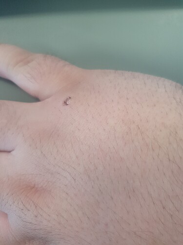

I’m at just over a week (10 days) and I’m absolutely loving it. I’m in the uk and did a self install (not recommended). Honestly I really enjoy the ease of use.

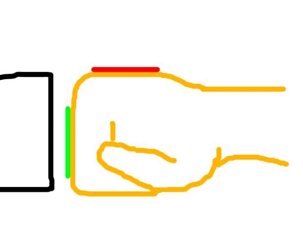

Even with the walletmor out, I cannot use my right hand to present a contactless card because my DF2 implant gets read together and the machines spur out: “Please present only one card at a time”.
While I had the walletmor placed on top of my finger bone, even presenting the walletmor flat to the reader while the df2 at 90 degrees angle I was still seeing the same issue.

This is a professional render of the 90 degrees angle I mentioned earlier:
Black: reader

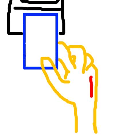

And this is another very professional render of a card presenting technique:
This new reader that’s popping around (it’s a very big white plastic handheld thingie) fails to me on both occasions above, even without having the Walletmor in my finger.
Always complaining: “Please present only one card at a time”.
